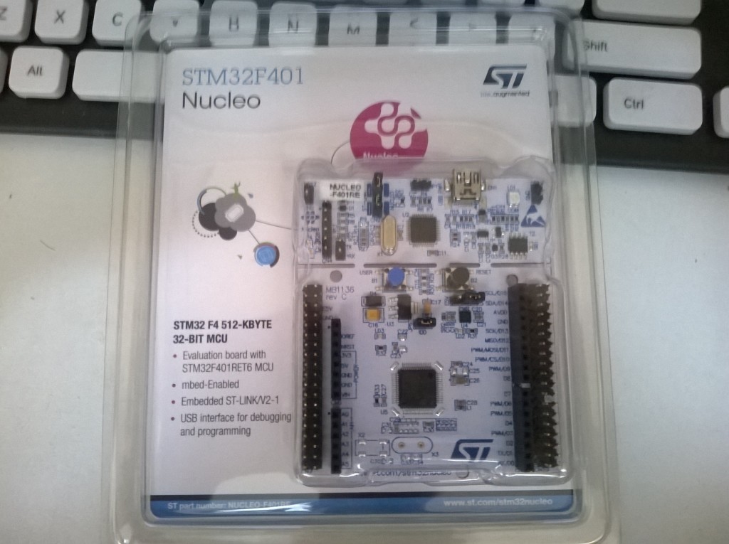

ST Corp. has just released an mBed platform prototyping board with Arduino shield slot: STM32 Nucleo I have that board right now, and will test it using mBed and with another compiler (Eclipse + GCC).
There are few models available and I choose the STM32F401 because of the floating point unit. However, you can choose the other models according to your application.
The integration to mBed is very straightforward, but to use another compiler is a very difficult task as the ARM microcontrollers can be very complicated for begineers. :)

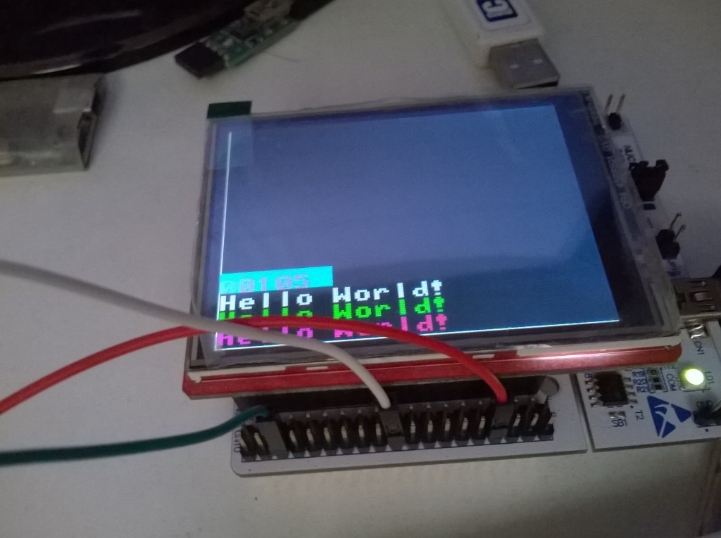

After a painful amount of trial-and-error, I got some of the things working in the Nucleo with Eclipse. Apparently, most of the libraries have changed to the STM32Cube so I could not fully use the examples from other websites. Worse of all, the documentations for the new libraries are very, very sparse. There are a lot of guesswork involved so patience is required.
I managed to have the ADC module to work here by using the software STM32CubeMX, single sample and also working with the Seeedstudio TFT shield (bought from Radioshack Malaysia). It's flickering due to the slow access of the pins which are not arranged in the straightforward way (all the pins from PortA, PortB and PortC scattered all over the board). The ADC here is sampling the LM35's output and the TFT shows "105", which directly translates to around 33 degrees Celcius (105 * 3.3/1024).
TFT code is from http://www.seeedstudio.com/wiki/2.8''_TFT_Touch_Shield_V1.0.
Unfortunately, mBed's analog-read doesn't support Direct Memory Access or other fancy features which I need for my work, therefore I didn't use it much.
