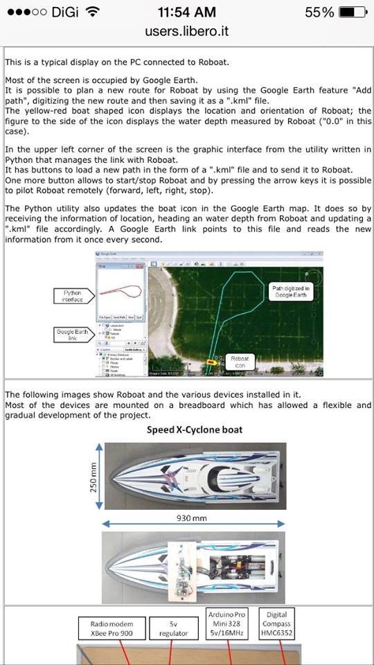

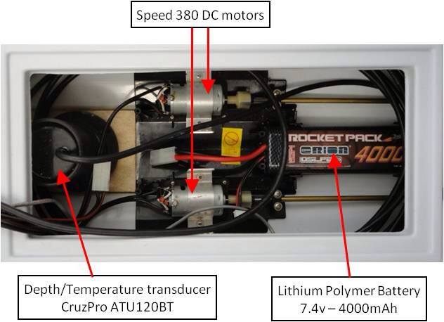

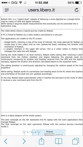

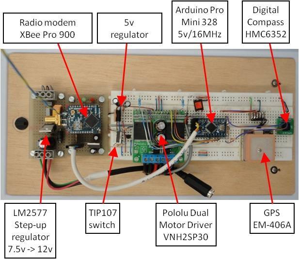

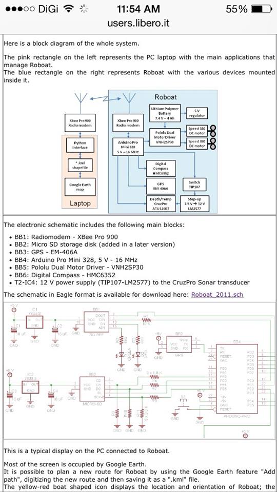

Postby shi kuan » Sun Oct 11, 2015 12:28 pm
Screenshot of the content :
I have made a collision avoidance system with simple ready-made code. What i did was using a ultrasonic sensor that switches off one of two dc motor so that it can steer away from floating object. Now i'm thinking of giving it a way-point to head to and return to its original. It also can return to its original position when battery is running low.
This is the link that inspired me.
https://www.youtube.com/watch?v=aCiyorya53g
The component inside that boat:
shi kuan

Schematic diagram:
Roboat_2011.zip
(48.12 KiB) Downloaded 1417 times

Postby ober » Wed Oct 21, 2015 8:19 am
It is not possible for us to go through all the codes :)
But I guess you can utilize some of Cytron stuff and building it will need your effort.
- Promini
- Digital compass
- XBee PRO series 1
- SKGPS
- MD30C or MDD10A depending on the motor current.
- DC motor, full range is here.
- Li-po battery
It is not direct replacement, that is why you need to try it out.
