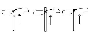

i used to build this way.
alumnium can from coke. cut into shape. careful punch a hole for the shaft. use suitable size cylinder rod hit hard on the aluminium piece placed on wood will create a good shape round shape hole.
then get lollipop plastic rod/stick which has hole in the middle. pass through the hole on the alumminium. use a lighter to melt the plastic to the aluminium. apply some superglue if needed after that. need lollipop plastic rod with hole because the motor shaft can go through the the lolllipop rod and is mounted that way to the motor. see picture below for clearer understand of my idea. if the aluminium is too soft, can try use can of canned food, but tat is really hard. need careful when cutting with scissors.
[img]<table%20style="width:auto;"><tr><td><a%20href="https://picasaweb.google.com/lh/photo/WpeR-ZhrWXH9UvAVXELHzeBRG7KLT-1LDvkuhSAuzkk?feat=embedwebsite"><img%20src="https://lh4.googleusercontent.com/_tX048BHzo5I/TXGeTkeUlLI/AAAAAAAAAB4/skYlj6PkFT4/s144/prop.JPG"%20height="63"%20width="144"%20/></a></td></tr><tr><td%20style="font-family:arial,sans-serif;%20font-size:11px;%20text-align:right">From%20<a%20href="https://picasaweb.google.com/inghui.hii/Prop?authkey=Gv1sRgCOjFqvOh0M2Vaw&feat=embedwebsite">prop</a></td></tr></table>[/img]
[img]<table%20style="width:auto;"><tr><td><a%20href="https://picasaweb.google.com/lh/photo/MksfOr0hJGaHZtE8R85JH6nL-lYZWXreo3que55VDD8?feat=embedwebsite"><img%20src="https://lh4.googleusercontent.com/_tX048BHzo5I/TXGhMOci4bI/AAAAAAAAACE/C4QpUHWHtwI/s800/prop_motor.JPG"%20height="134"%20width="115"%20/></a></td></tr><tr><td%20style="font-family:arial,sans-serif;%20font-size:11px;%20text-align:right">From%20<a%20href="https://picasaweb.google.com/inghui.hii/Prop_motor?authkey=Gv1sRgCKCl7q-P3KbnpAE&feat=embedwebsite">prop_motor</a></td></tr></table>[/img]

Postby ABSF » Sat Mar 05, 2011 11:11 am
The "Img" doesn't accept pictures in BMP format. You'll have to convert them to JPG first then attached them as files.
Allen.
Like this:
propeller
propeller with motor
