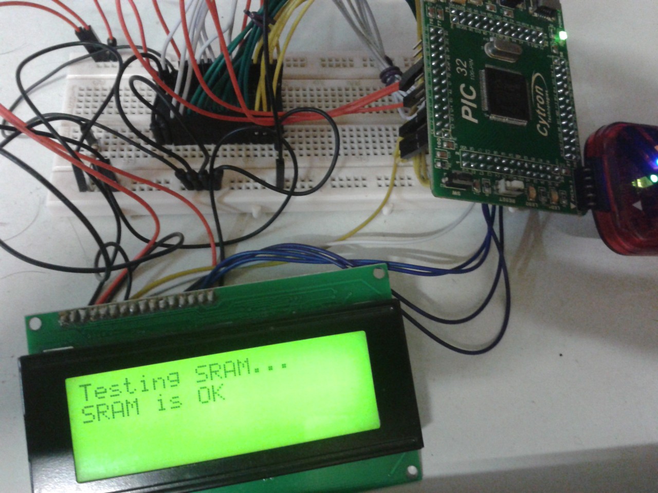

SRAM Test Successful

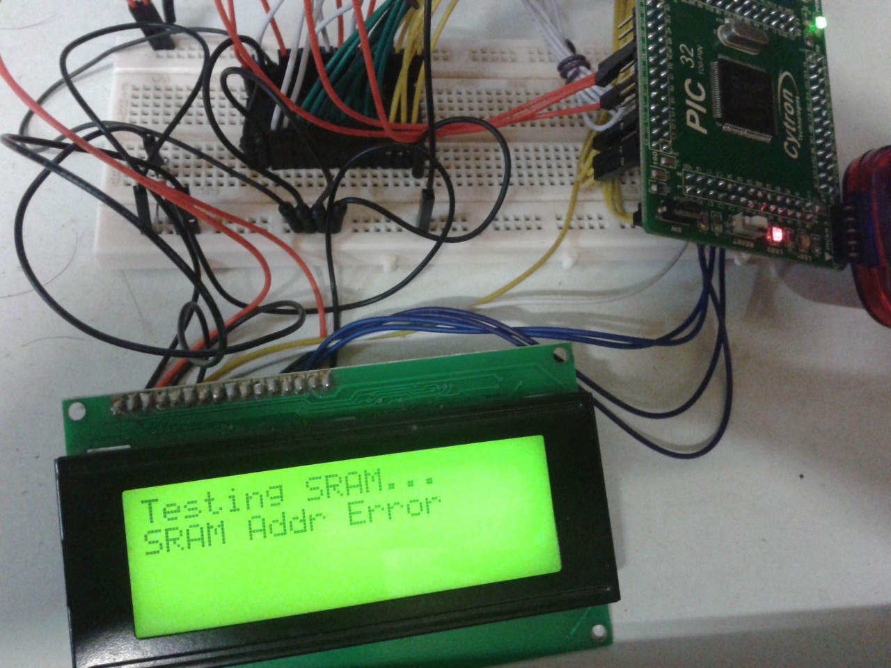

SRAM Test Failed - Chip disconnected from power supply during test.

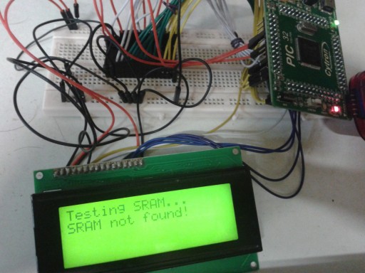

SRAM Test Failed - No chip detected prior to test.

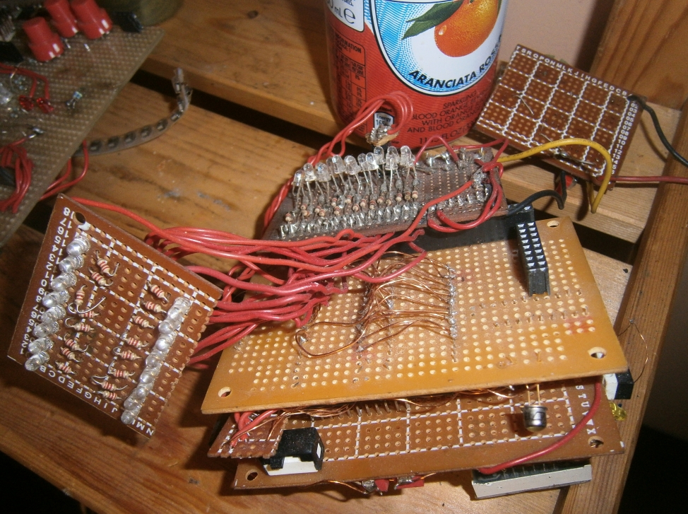

I have interfaced 128K static RAM with PIC 16f884. Some time ago.
I even made LED panels for address/data bus.
One 16bit bus is used for data, and that is also latched for the address.
The control program (in assembler) just to write a pattern into the RAM, and read it back is actually complicated, and stretching over pages. It works, however.
The wires used are a big mess, all soldered...

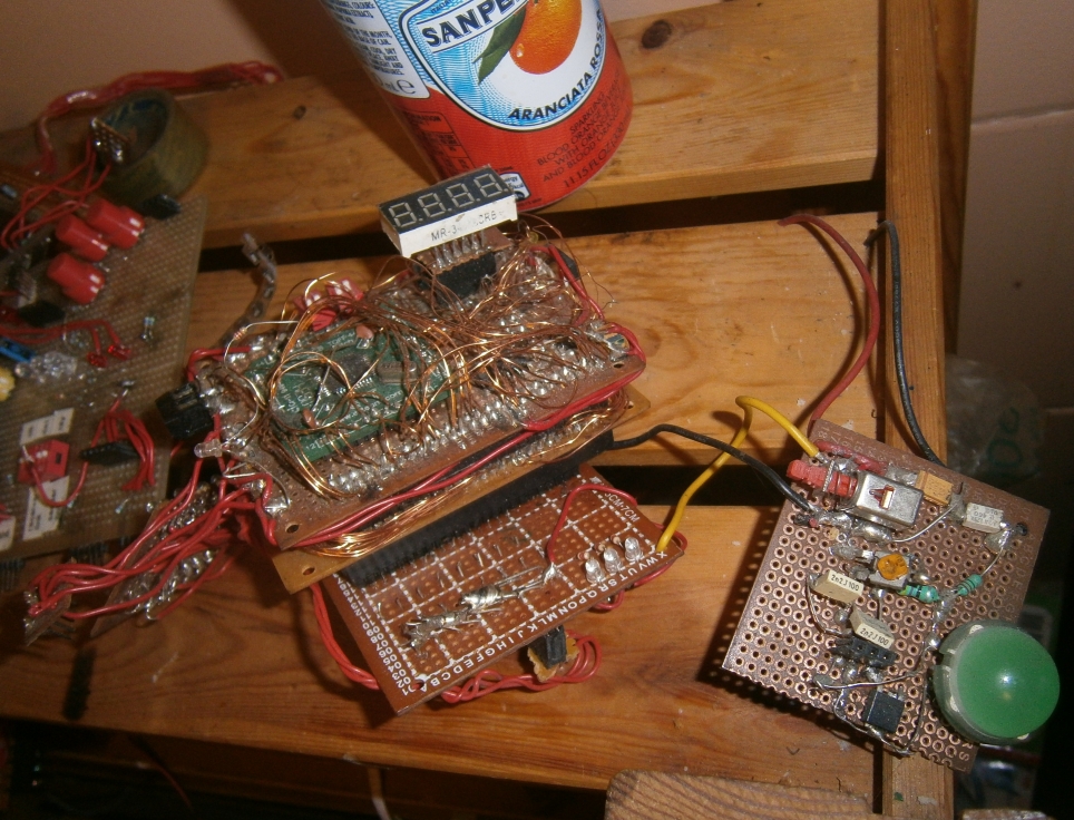

The wiring for my 16f884 based 68000 bootloader is worse.
Actually it took me a long time to do it.
It works! It can write patterns to RAM, and read back, 128Kbyte X 16bit.
But it was too much effort to develope it further.
Actually rebuilding from start using the PCI backplane takes less time altogether!
There is serial LED display, and 2 LED panels for the data bus/address bus.
And the RAM chips between the two PCB. with a lot of wire that is not seen.
There is not schematic so it takes an hour or so each time I do more work on it.
PCI should be easier to maintain...
If I find so much time one day. The magnet wire was also hard to use, remove the isolation each time.
