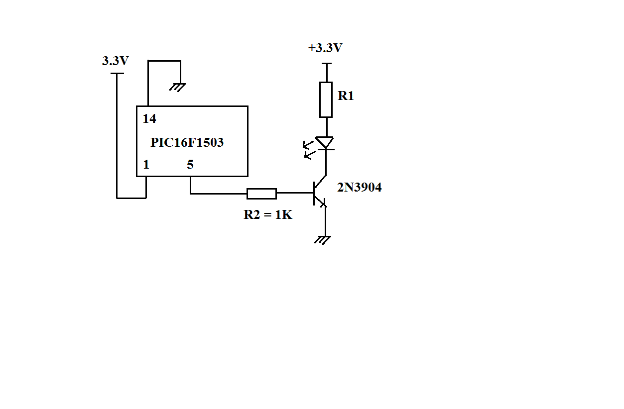

Project Description: Mini LED candle
What will you do if you have mini 8 and 14-pin microcontrollers lying around on your desk? They are good for small battery operated projects.
Also, the mooncake festival is on the corner. So, without having to burn yourself with candle (or the lanterns), you can use 2AA batteries, an ultra-bright LED and a microcontroller! (alongside with a transistor and some resistors).
Compiler: MikroC v5.60 (can be compiled in demo mode)
Hardware:
- PIC16F1503 (PIC10F and PIC12F are encouraged, but with modifications of code)
- Ultra-bright LED (orange/yellow) and a suitable resistor (R1) for maximum brightness. Please refer the LED's datasheet and select a resistor which allows acceptable level of current or you risk frying it!
- 2N3904 transistor. (these things are everywhere)
- a cut, tiny veroboard/stripboard/donutboard
- another resistor (1K)
How the "flickering candle" work: By exploiting the PWM module inside, we can control the LED brightness easily. The "flickering" is caused by the random numbers generated in the microcontroller. The random-number generator isn't any random, it's pseudo-random, which means it is a Linear Shift Feedback Register (LFSR). The numbers will repeat every few hundred numbers, but it is very hard to notice, hence it's being pseudorandon. On every each time (like 50miliseconds in the project) there will be a random number sent to the PWM registers.
Schematic:
Schematic

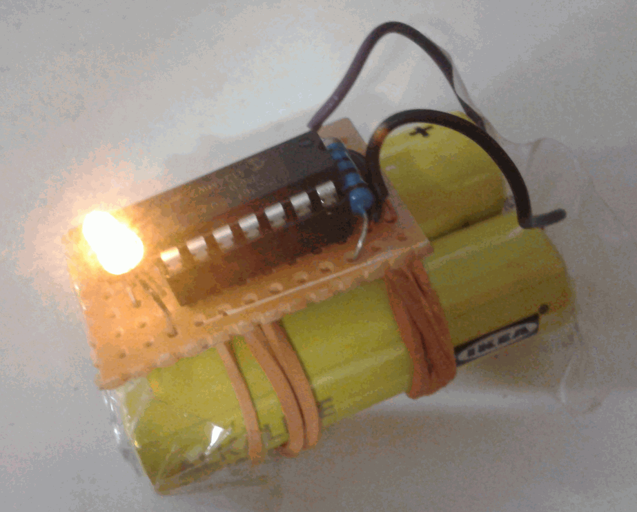

Picture:
LED candle with 2AA batteries
(It's flickering, but I can catch only one brightness on the camera)

Note: The microcontroller is running without crystal, only 62.5kHz internal oscillator and a approximately 60Hz PWM. The low speed is used because it's meant for battery operation.

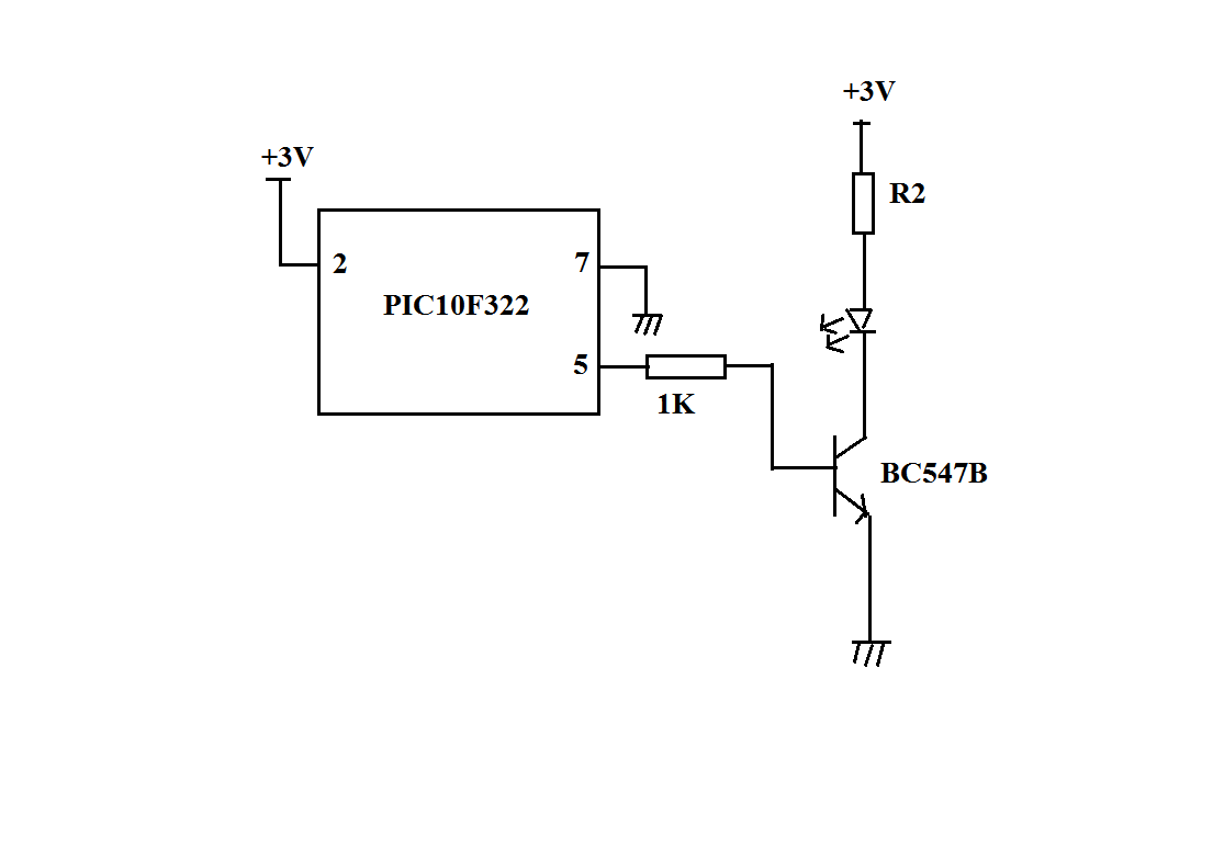

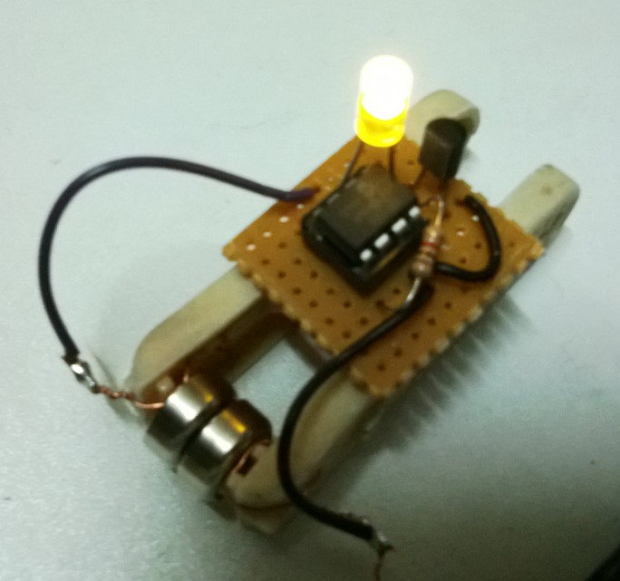

The Mooncake festival is at the corner, so why not build another LED candle? Place it in the lantern, of course. This time it's using a PIC10F322, and a clothespeg (special thanks to Mats Engstrom from SmallRoomLabs, Malaysia - Instructables) to hold the AG13/LR44 batteries.
Components:
PIC10F322 microcontroller
8-pin DIP socket
1K resistor
BC547B transistor
a current limiting resistor for LED, R2 (check the LED datasheet for the maximum allowable current)
LED (ultra bright yellow recommended)
two AG13 batteries (can be bought cheap from Mr.DIY or something)
Schematics:
Schematics
Picture:
Electronic candle
How it works? First the microcontroller starts by sampling the electronic noise from an ADC pin, then it is placed into the pseudo random number generator as a seed. Then, every 100ms, the random number generator creates a random number, and place into the PWM module which controls the brightness of the LED. So you will see the flickering, almost like a candle. There are limitations, of course, like the sequence of the random numbers are the same if you stare it long enough, but usually you will forget it fast enough too, because on every start of the candle, the seed for the generator is different. :)
This thing shuts off into sleep after 3 hours (or you will bleed these poor AG13s dry), so if you need to restart it, rip out the batteries and place it again.
