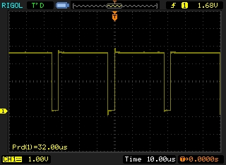

Note: For those who wants to test the VGA (at 640x480 resolution) code - make sure the Horizontal Syncs and Vertical Syncs are all accurate.
Here's the H-sync (Horizontal Sync) in oscilloscope:
Horizontal Sync profile.
The H-sync periods are approximately 31.77uS. The H-syncs are controlled by Timer2 in the PIC32. Any more or any less than that, your monitor won't be getting any signals. These H-sync "low-pulse" is generated by the Output Compare interrupt after approximately 3.77uS. Seperately, and meanwhile, then comes another Output Compare interrupt where the DMA started streaming pixels for 25.17uS.

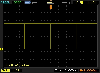

Here's the V-sync (Vertical Sync) in oscilloscope:
Vertical Sync profile.
The V-sync periods are aprroximately 16.67ms. On a number of H-sync periods, the V-sync is "low-pulse", and then for an amount of 480 H-syncs alongside with the streaming pixels, you get a frame. One picture frame. Here's the entire signal profile, for easier reference:
