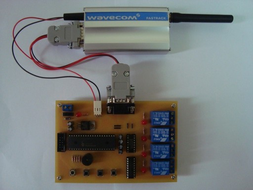

Project Name: GSM Switch
Author/Designer: Shahrul Nizam
Project Description: Switch 4 relay with command by SMS. Can SMS to turn ON and turn OFF.
Photo/Picture/Figure/Diagram/Flowchart:
Compiler: Hi-Tech
Video: PIC Project GSM Switch

Postby shahrul » Thu Apr 26, 2012 5:09 pm
I update the code. It can use for any no of relay from 1-8. In this hardware I only use 4 relay.
Also I add 2 new command for 'ALL ON' and 'ALL OFF'
My Project.rar
(177.32 KiB) Downloaded 1840 times

Hi. I'm a student and I'm doing a project which requires me to connect my microcontroller(8051) to some 240VAC home appliances using relay. I don't know which relay should I use but my project is a bit similar to yours, so I think I can use the same type of relay. So can you tell me what model of cytron relay circuit you used in the circuit? that will help me a lot. Thanks.

adamidon WROTE:Hi. I'm a student and I'm doing a project which requires me to connect my microcontroller(8051) to some 240VAC home appliances using relay. I don't know which relay should I use but my project is a bit similar to yours, so I think I can use the same type of relay. So can you tell me what model of cytron relay circuit you used in the circuit? that will help me a lot. Thanks.
Relay no model. Just go to electronic shop and pick relay with the current rating you want.
