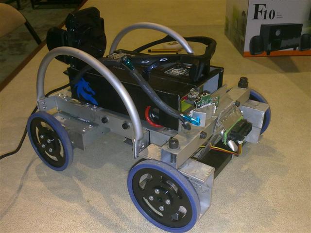

this project i done for my FYP at UTM skudai
Project Name: gaze driving
Author/Designer: mohd zhafri
Project Description: drive mobile robot using eye movement
Photo/Picture/Figure/Diagram/Flowchart:
Compiler: C30 c compiler for mobile robot and the GUI i used VC+ MFC and openCV
mobile robot

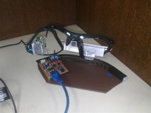

gaze tracker

redips_id WROTE:Nice project! :) what type of PIC you used? Can you explain the operation of this robot?
i'm using dsPIC30f4011. i prefer to used this PIC because i already familiar with it. this robot is basically been control (forward,stop,turn left and right) using our eye pupil movement. the image processing part was done at computer and than the data been transfer to microcontroller using XBee.

Postby sich » Mon Apr 18, 2011 2:31 pm
Awesome FYP project! Are u using a webcam? What's the function of the IR (looks like) LEDs?

Postby zhafri » Mon Apr 18, 2011 2:58 pm
sich WROTE:Awesome FYP project! Are u using a webcam? What's the function of the IR (looks like) LEDs?
yup...i'm using normal webcam...that IR i want use it to filter visible light..but its already burn..so i'm not use it
