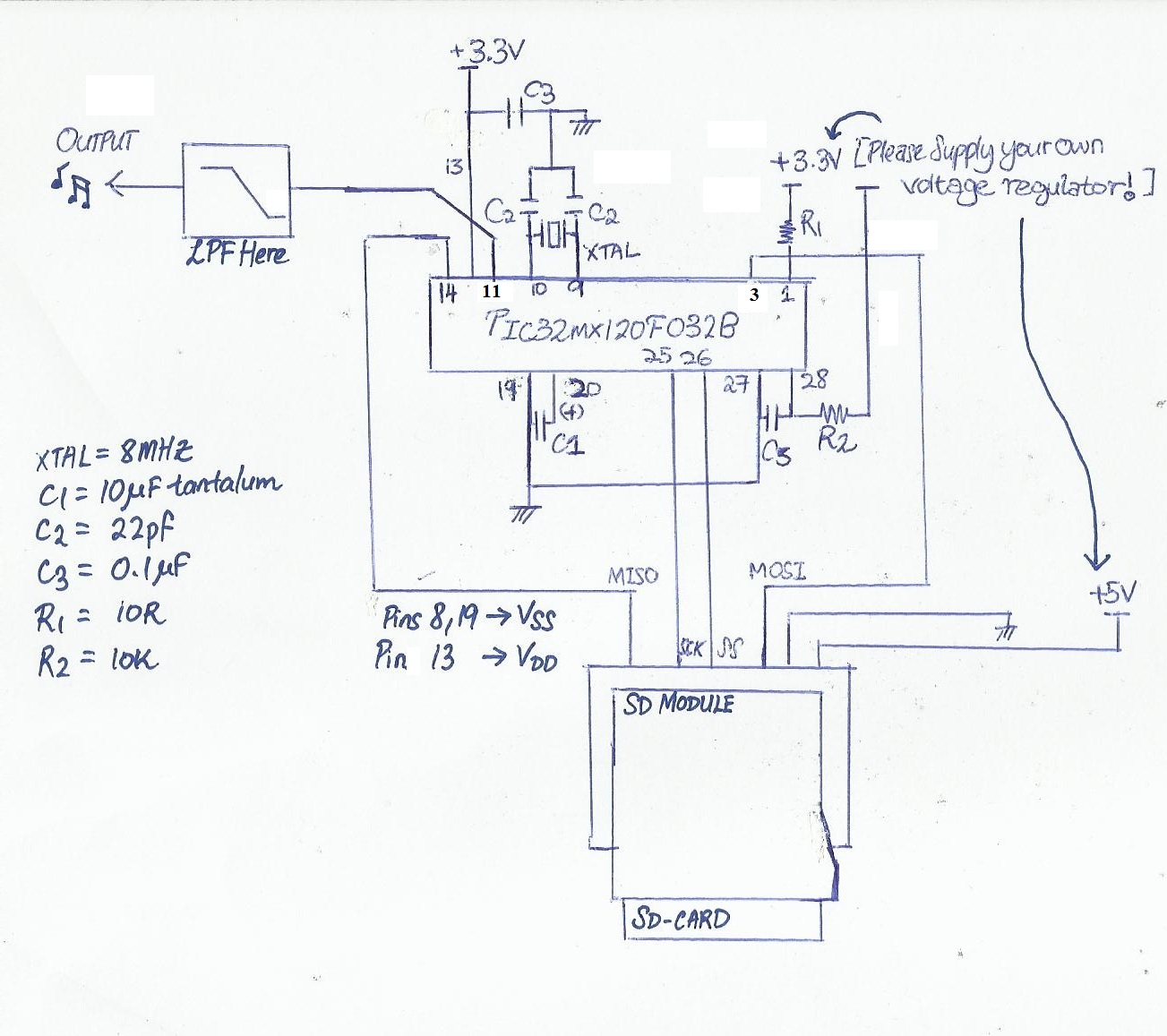

Schematic:
Schematic of the Project
Source Code: "test2-wav.zip". (It was in a test when I try to make that thing, hence the name.)
Remarks: The "HardwareProfile.h" in the "C:\Microchip Solutions v2011-10-18\MDD File System-SD Card" (or where you installed it) has a bit of a problem - it detects the "CD" pin on the SD-Card holder, which could be a problem if you need to save some wiring. I'm supplying the modified "HardwareProfile.h" inside to prevent the system from detecting the "CD" pin. You need to extract the provided "HardwareProfile.zip" into the "C:\Microchip Solutions v2011-10-18\MDD File System-SD Card" and overwrite it.
If you have problems compiling because of the missing "system.h", go to "Project->Build Options->Project", then click on the "Directories" tab, then the drop-down menu "Show Directories For", and select "Include Search Path". On the "C:\Program Files (x86)\Microchip\mplabc32\v2.01\pic32-libs\include\peripheral" in the box when it's selected, take out the space and the "(x86)" after the "Program Files". It should be this: "C:\Program Files\Microchip\mplabc32\v2.01\pic32-libs\include\peripheral".
The UART is optional. It is just for debugging purposes.
Note: LPF (Low Pass Filter) values suggested a 0.01uF capacitor and a 1K resistor. Connect the output to Pin 11 after the LPF. Use a small speaker.
