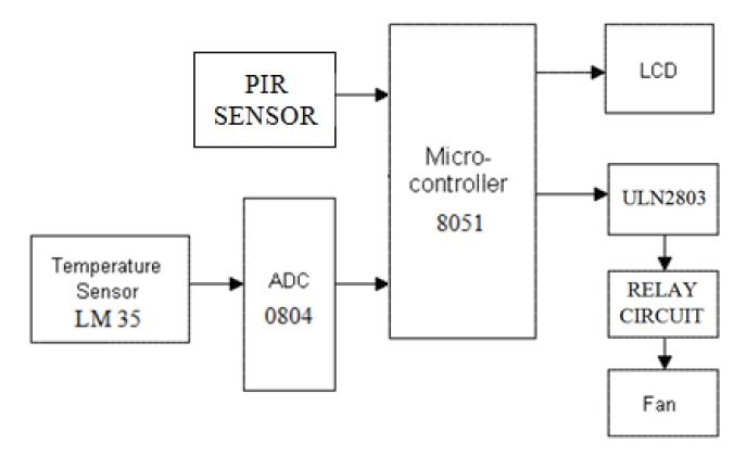

Block diagram for Project
PROJECT DESCRIPTION:
This project concept can be used for single room where only one person can enter and leave the room. If the person enters the room, the PIR sensor placed beside the door will detect and send signal to microcontroller 8051. PIR sensor signal will ON the fan and operates at automatic speed level selected by microcontroller logic operation based on temperature detected using LM35 temp sensor. 5V DC Relay is used for fan speed switching. LCD display will display the fan speed level and temp value. When the person going out of room, the PIR sensor will detect again and this time the fan will OFF and LCD display will display "FAN OFF".

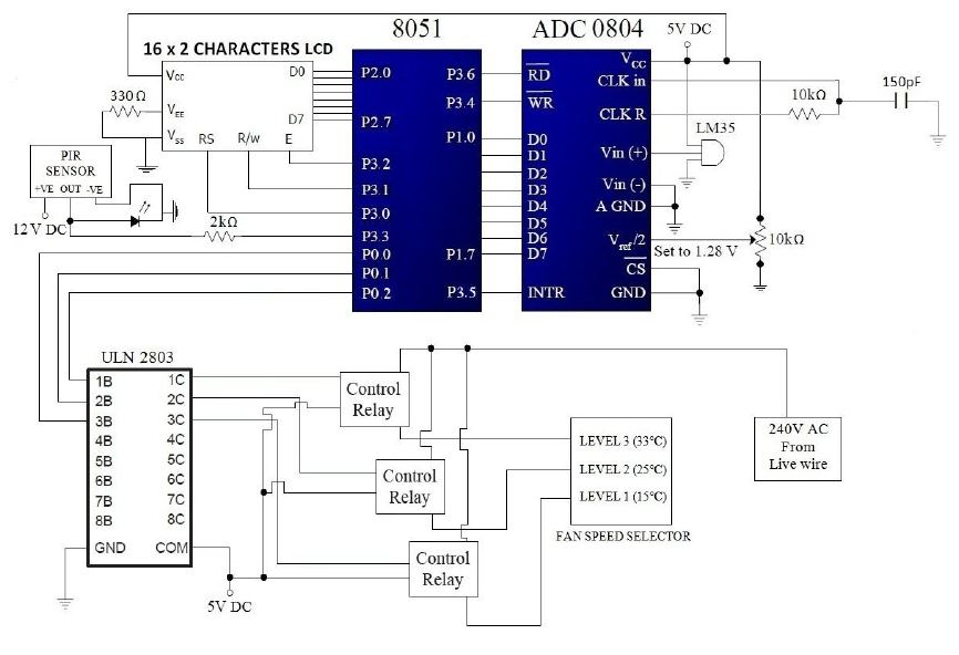

Schematic diagram for Project

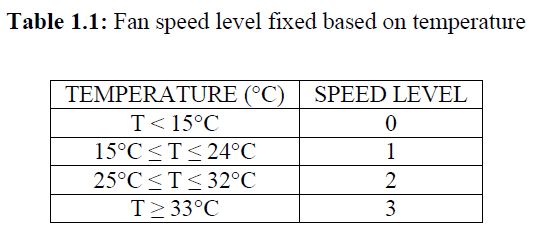

I like 8051 and have some ADC0808 & ULN2003 leftover from my previous project. After seeing the circuit I'd like to try it out first on my simulator. I read the source code and was unable to print or copy/paste it onto the 8051 assembler. Would you please unprotect it so we here can try out the project? Or you are making commercial products from this design then just ignore what I'd said...

Yes, I agree. This project is good for learning 8051 assembly lang. and demo purpose. For practical use and compactness, one could redesign it using a 16f886 or 16f876A which would save the cost of ADC and using 3 transistors for the ULN2803. This will reduce the board size as 8051 doesnt have ADC built-in and is a 40 pin DIP.
