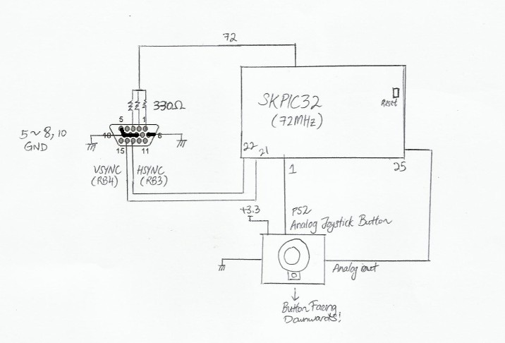

The laser shooter is controlled by the player through the PS2 Analog Joystick by Cytron, and the analog values are decoded in in the microcontroller on the fly.
The VGA part is controlled directly by taking advantage of the "Output Compare" modules in the PIC32, and all the Horizontal Sync and Vertical Sync are precisely timed. The horizontal drawing is done by using SPI, hence the 1-bit colour. An attempt to use partial shades and halftones are done but due to the PIC32's high-speed cache, this cannot be written in assembly code as each instruction in this MIPS processor has inconsistent number of cycles.

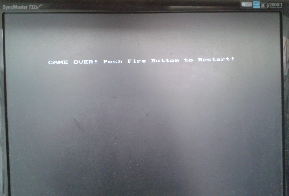

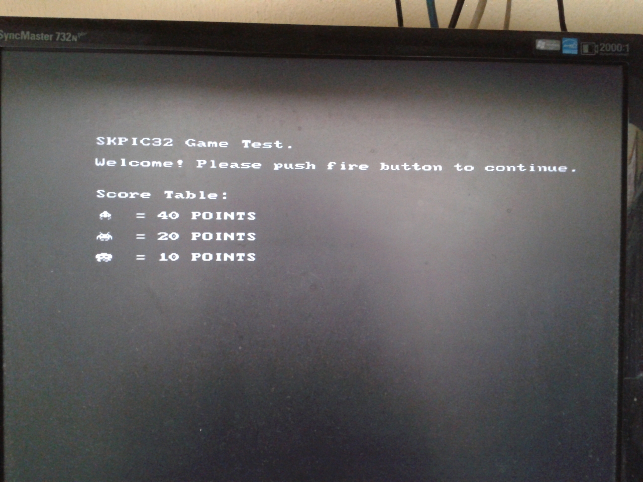

Photo:
Front Screen
Game Over Screen
Game in Progress

Schematics:
Schematic
