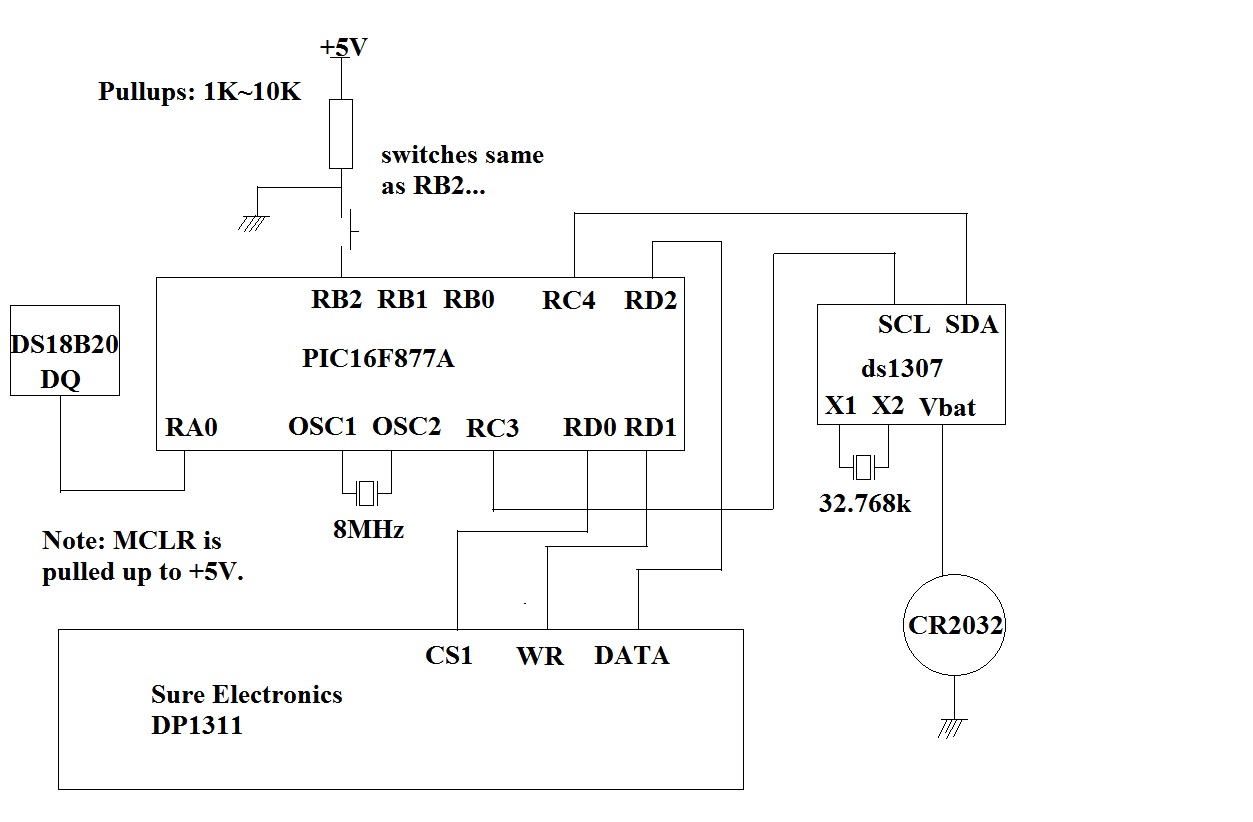

Schematics:
Schematic
(Pullups to DS1307 data and clock lines are not shown in the schematic. And power supply connections are all +5V.)

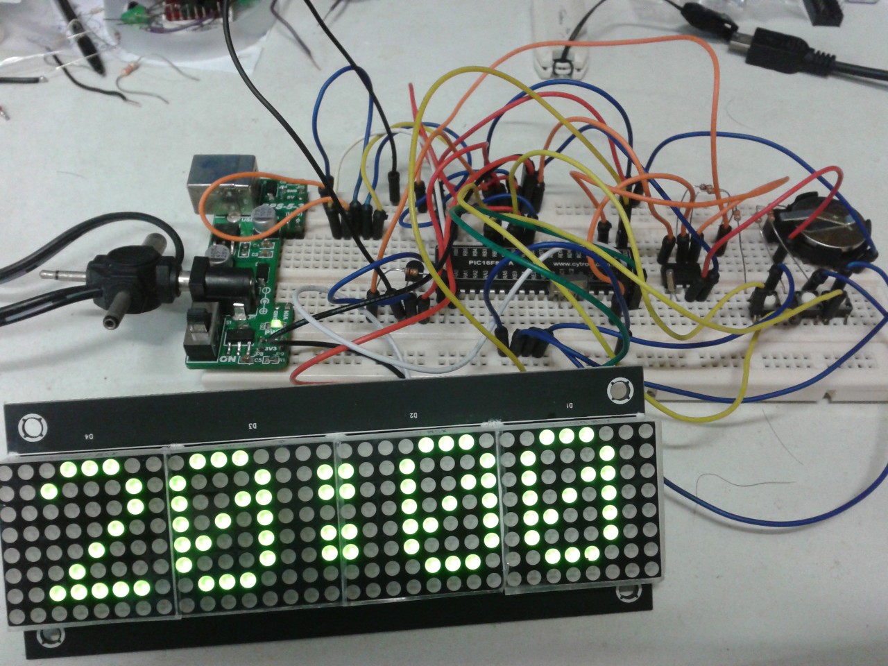

Picture::
LED Matrix clock in action
