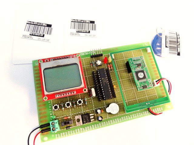

This project shows the interfacing between HF RFID reader and PIC microcontroller.
Hardware diagram, consists of:
1. HF RFID Reader
2. PIC16F886
3. 13.56MHz Mifare-1 RFID Tags
4. Electronics component
The HF RFID specification:
~ Model: RDM880
~ R/W chip: MFRC500
~ Standard: ISO/IEC 14443 type A
~ Frequency: 13.56MHz
Product Link
Product Wiki Page
Communication Protocol:
[0xAA---Station ID---Length of Data---Command---Additional Data---XOR Checksum---0xBB]
Each com­mand begins with 0xAA and ends with 0xBB.
The XOR check­sum is cal­cu­lated by XOR’ing each byte of the msg, exclu­sive the 0xAA and 0xBB byte.
For detail you can refer to the links inside the Product Wiki Page.
Operation:
SW1:
~ Read UID no, start address 0x10, no of block = 1
SW2:
~ Write UID no, start address 0x10, no of block = 1
~ Data: 00112233445566778899AABBCCDDEEFF (HEX: Total of 16 bytes)
SW3:
~ Data: 00000000000000000000000000000000 (HEX: Total of 16 bytes)
Video:
Schematic and Source Code:
Schematic and Source Code.rar
(850.29 KiB) Downloaded 474 times
Enjoy it & Selamat Berpuasa! :D
