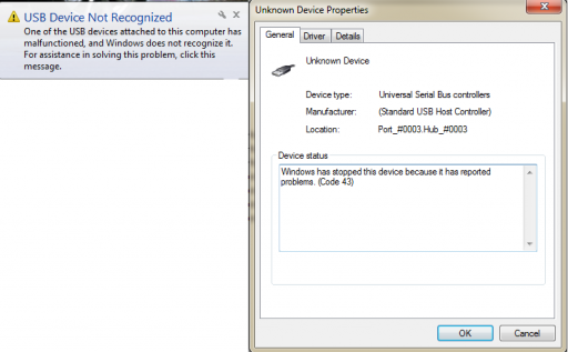

Postby pikachuX » Sun Nov 02, 2014 2:04 pm
Hi,
I had try it in another pc but still have an error which i already attach the picture below. Please take a look.

Re: CIKU Bootloader Problem
Postby Idris » Mon Nov 03, 2014 2:05 pm
Hi pikachuX,
If you have UIC00B, you can try to re-download the CIKU bootloader to CIKU board using PICkit 2 software. You can find the bootloader file under CIKU product page here. But if you have difficulties to do that, or the error still exists, you can fill up this form. Our technical support team will follow up on your problem. You might need to return the product to Cytron Warranty Division for us verify the problem.
