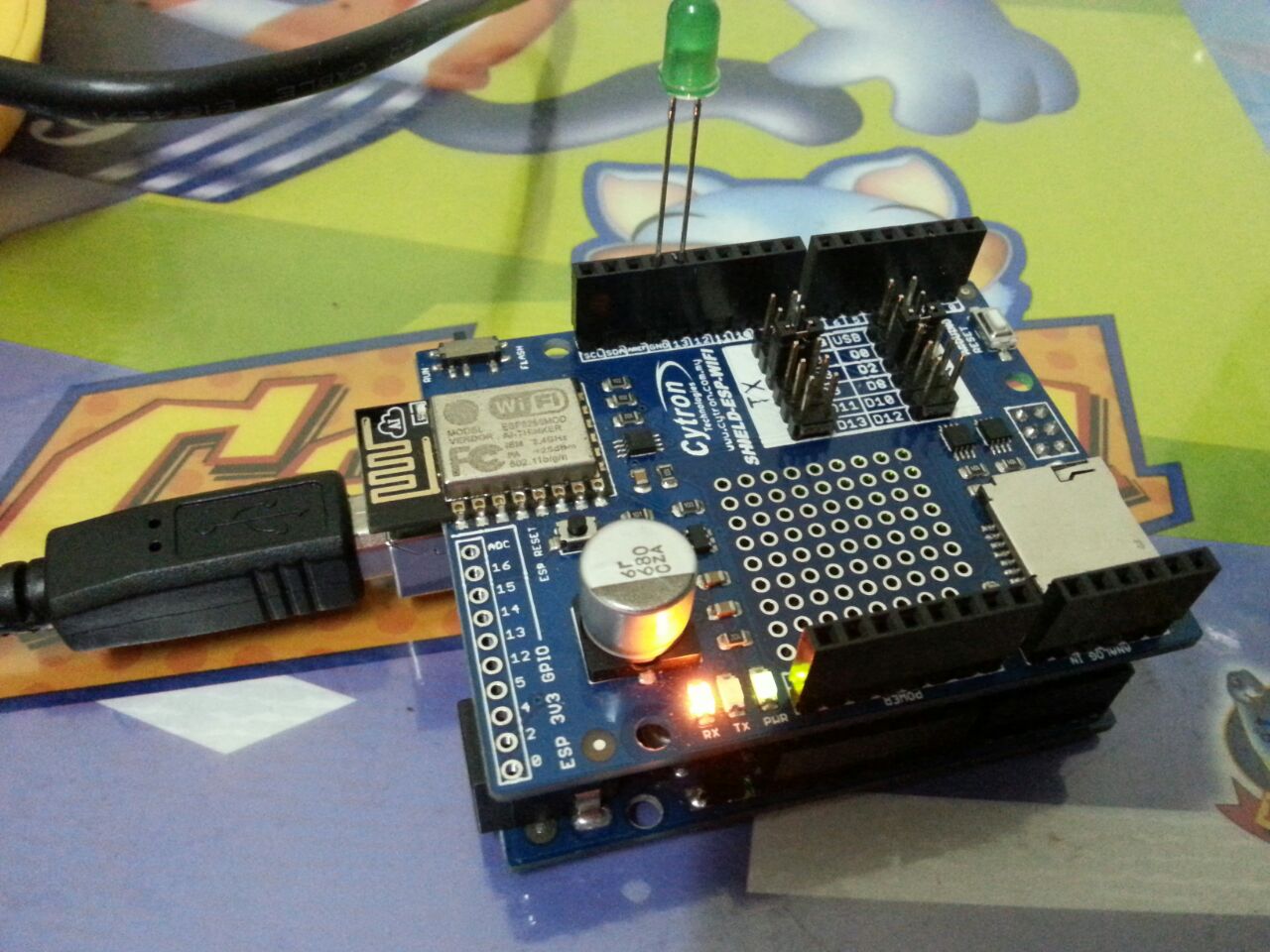

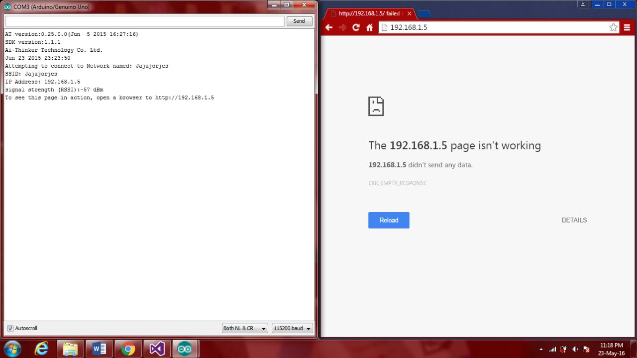

tq for the reply. im using Cytron wifi shield esp 8266. it suppose to connect to the network and show the result. how ever, when it manage to connected through the network, the tx and rx led is stop from blinking and the blue color on the esp also stop blinking. when i opened the ip address on the browse, it say that my arduino not send any data..here i attached with the image..

as you can see..the RX led is always ON when it able to connect to the network..how ever the TX is not blinking
the view on serial monitor and the web server..

The problem might come from do{...}while(1); The program will keep running in this iteration and will not go back to the first line of void loop(). Function server.available at the first line of void loop() is important for continuous connection between your browser and wifi shield. So you can try reorganise the coding and see if the problem still exists.
