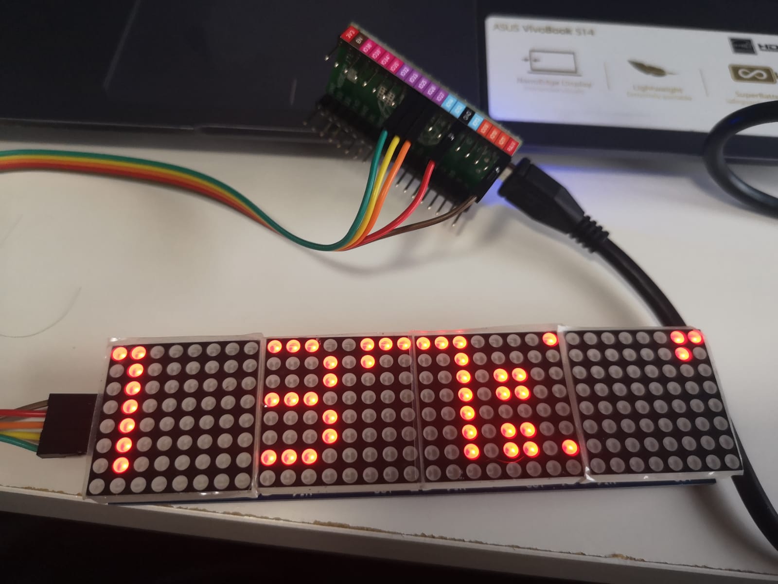

This is my first time getting a Arduino kit to star exploring it, however i'm having some issues.
I'm following https://tutorial.cytron.io/2019/10/23/d ... ing-esp32/ , it seems all pin are proper and setup are correct.
The dot matrix display seems to be not in the right order, what could be wrong? Please refer to pic. Thanks!

Hi zhixiong86,

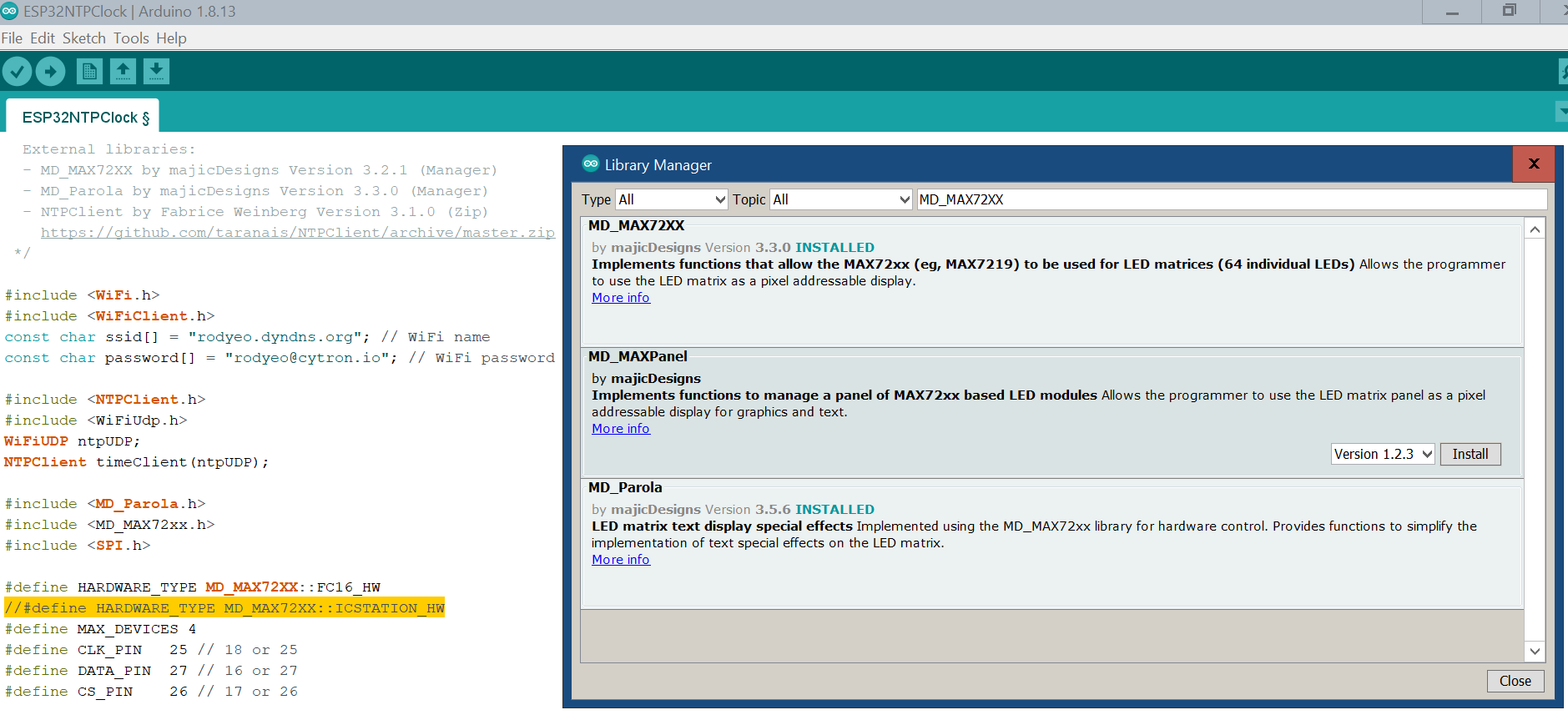

Try to edit the code. Uncomment line 34 and comment line 35. In other words, try to #define HARDWARE_TYPE MD_MAX72XX::FC16_HW and program again. Please let me know the result. Thanks.
Re: Unable to get Dot Matrix Clock working properly
Postby zhixiong86 » Sun May 10, 2020 6:17 pm
Thanks, it working now!

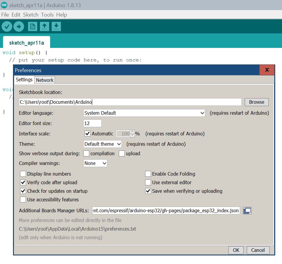

What to do if a non listed device in the Board Manager Library... add aditional board manager url link at ... Click 'File - Preferences', click the link below, copy the 'Stable release link' and paste it in 'Additional Boards Manager URLs'
CODE: SELECT_ALL_CODE
 https://github.com/espressif/arduino-esp32/blob/master/docs/arduino-ide/boards_manager.md

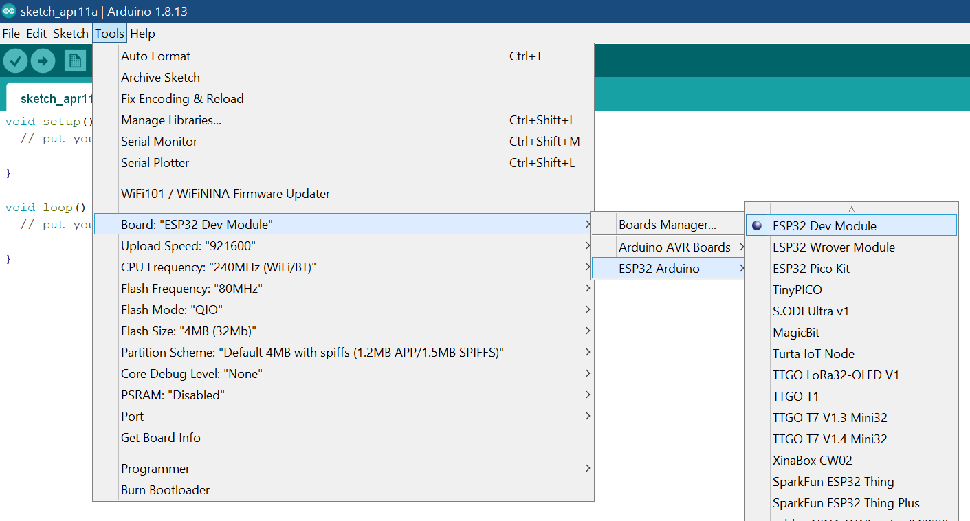

Then click 'Tools - Board - Board Manager...' Wait for a while for 'Downloading platform index'. Scroll down, install "esp32".

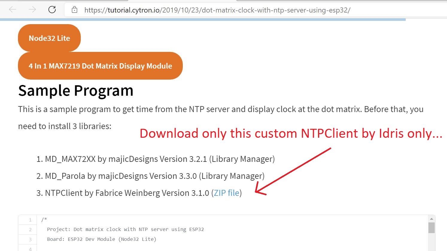

*** Important: Please download and use custom NTPClient v.3.1.0 Library Manager created by Idris @ Cytron.io only, else you will get error... "No Clock Time display on the Dot Matrix Display". https://github.com/taranais/NTPClient/a ... master.zip
