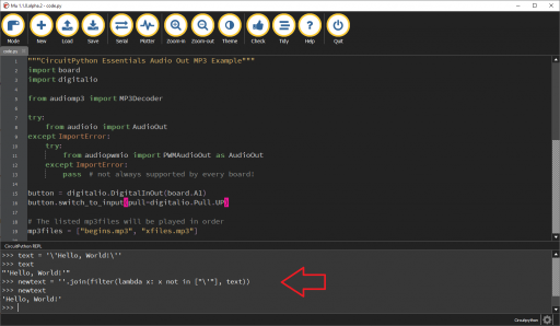

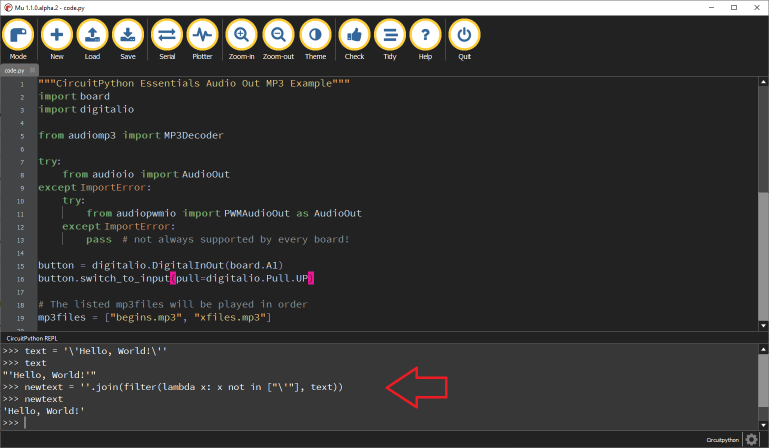

Hi Robert,
You can use filter() function in python to filter certain character. For example.
Reference: Python : filter() function | Tutorial & Examples
