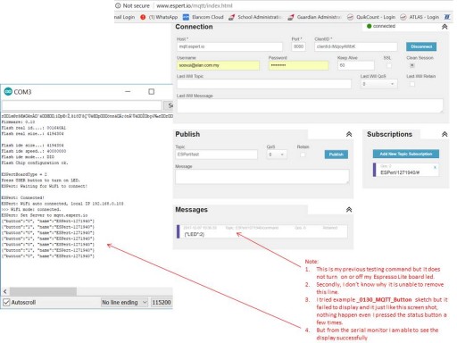

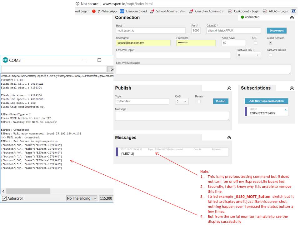

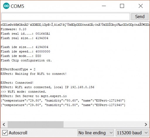

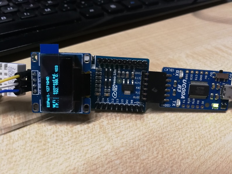

Here are the screenshot on MQTT websocket panel, OLED led, arduino serial monitor attached.
I tried many times but still cannot. Really dont know what went wrong. I tested the temperature and humidity on other examples tutorial no problem and ok. I tried in my home and office also cannot and I did not block any services from both of my home and office routers.

From the Arduino serial monitor, seems like your espresso lite cannot connect to MQTT server, this explains whole thing can't work.
To verify this, you can change another SSID and password for your espresso lite (example your phone wifi hotspot) and test how it goes. If espresso lite is successfully connected to MQTT server, the serial monitor should shows something like "MQTT: connected" or "OutTopic:...", else it means fail to connect to MQTT server.
