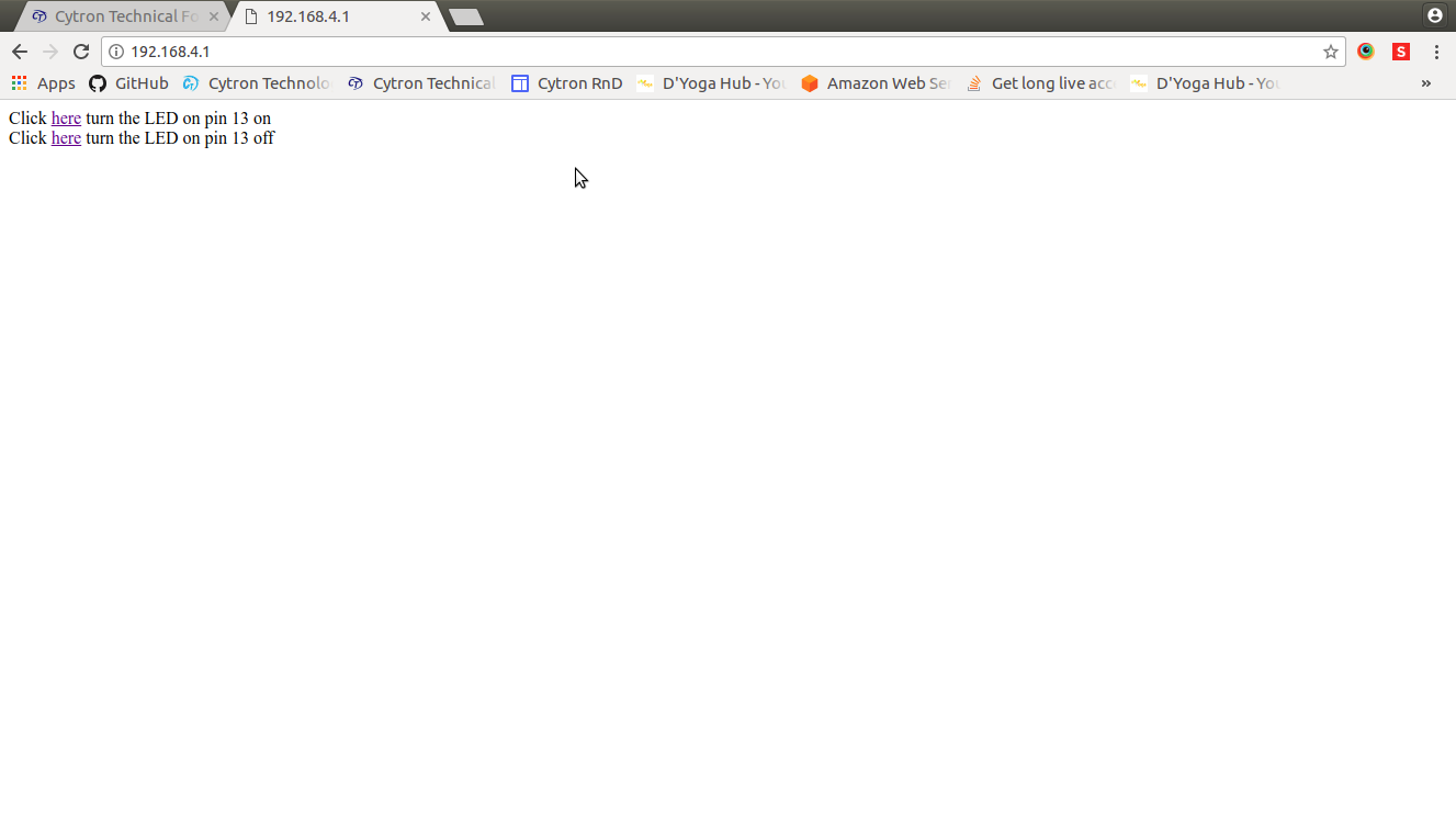

Postby bengchet » Tue Apr 03, 2018 10:42 am
Example WiFISoftAP is what you need. In the sketch, you just define your own SSID and password, and use mobile phone to connect to this SSID. Then open browser on your mobile phone and enter 192.168.4.1.

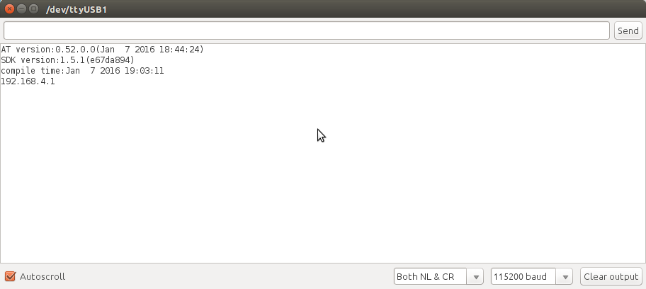

Postby khvmaths » Tue Apr 03, 2018 4:09 pm
AT version:0.52.0.0(Jan 7 2016 18:44:24)
SDK version:1.5.1(e67da894)
compile time:Jan 7 2016 19:03:11
Setting softAP failed
192.168.4.1
This is what i encountered

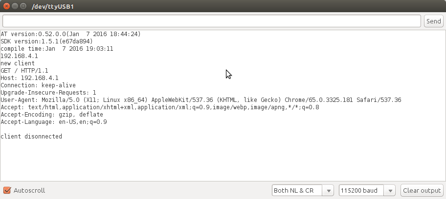

Re: Wifi Shield without Hotspot
Postby bengchet » Tue Apr 03, 2018 6:08 pm
I tested with no problem.
May be you can try different SSID and password? Try simple SSID name with password (at least 6 characters) and see how it goes.
