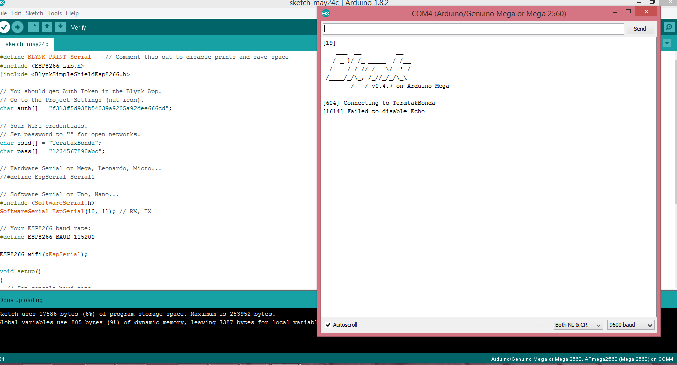

i already use the sketch from post but my serial monitor show this,

Hi Syaabani,
If not mistaken, software serial is quite hard to handle high speed baudrate (i.e 115200). You can try to lower down the baudrate to 9600bps.

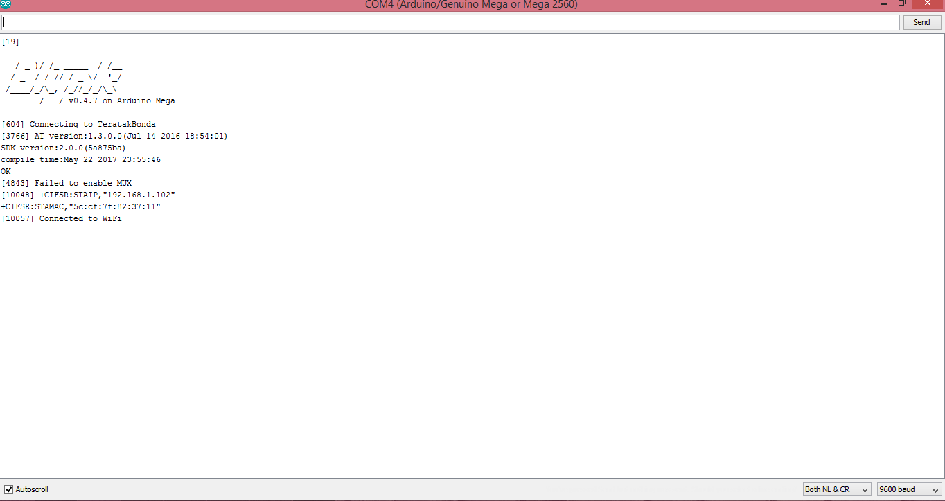

You can add few lines as the code shown below. This is to reset the ESP8266 module before starting the program to solve "Failed to enable MUX" issue.
If it shows "Failed to disable echo" issue, it is pin selection problem for UART, so you need to double check either the mini jumpers or at the coding.

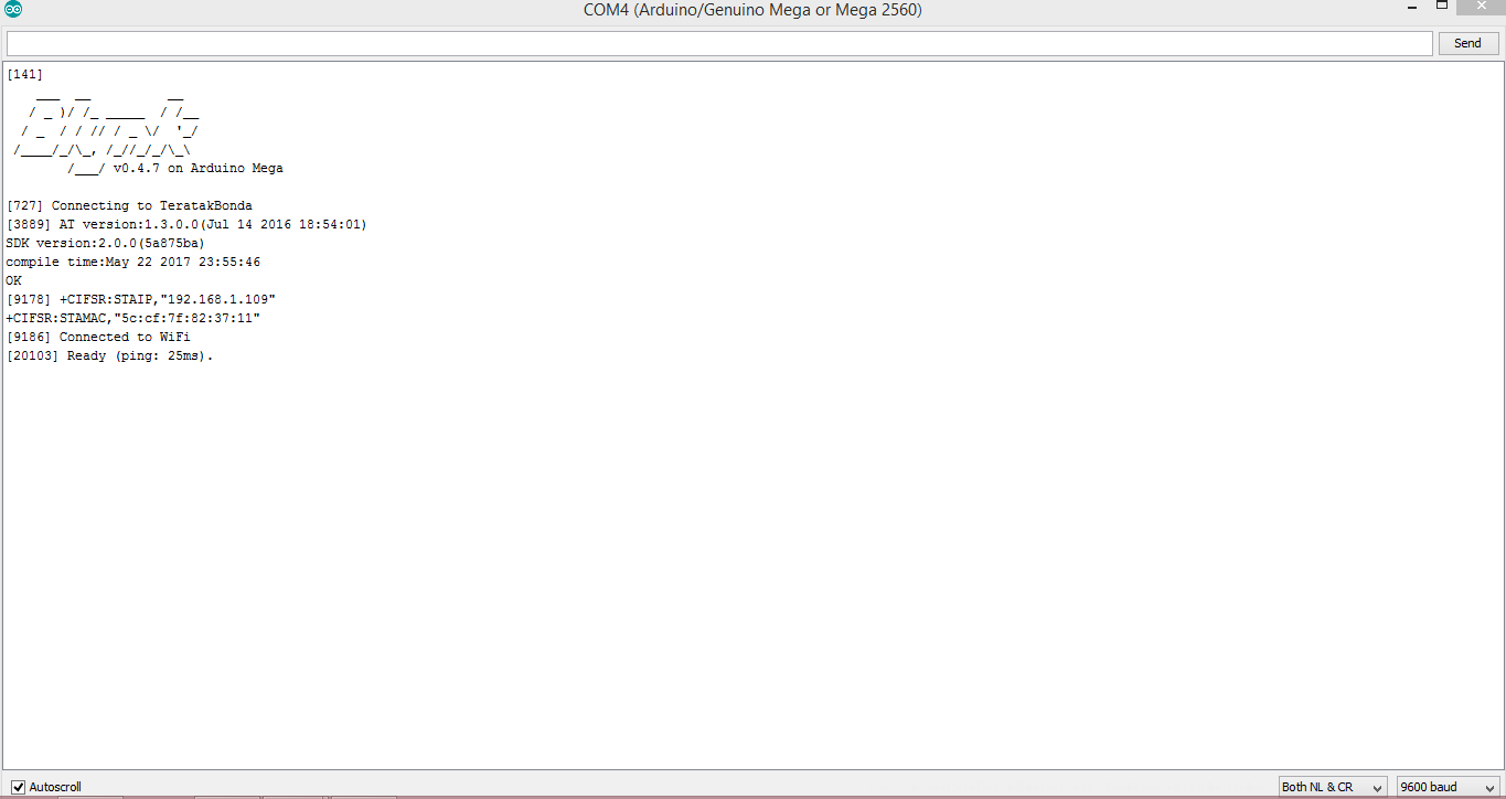

Attached is also screenshot of my test, I used Uno, but it should work for Mega as well.
