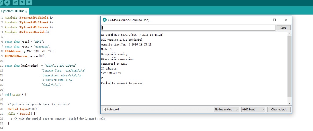

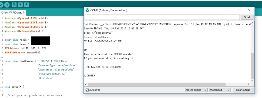

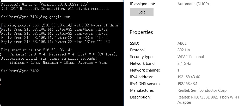

Postby poonjon » Thu Jan 11, 2018 8:27 pm
Attached are 3 screen shots with descriptions. I'm using the cytron wifi example code, the only settings that i changed are SSID, password and IP.
arduino wifi connection works when i connect it to my home wifi
arduino wifi connection to server fails when i connect it to my mobile hotspot
this is a reference, it shows that my mobile hotspot is in fact working when my laptop is connected to it
