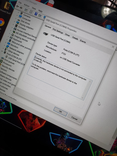

My computer is able to detect the makerphat. However, once it is mounted on top of the Raspberry Pi, the connection is immediately lost and the computer is unable to detect the makerphat all of a sudden. I have tried many different ways of troubleshooting to resolve the error code displayed (Code 45), but to no avail. I hope to be able to receive your help as this is part of a very important project! Thank you!
Error message displayed once mounted on Raspberry Pi

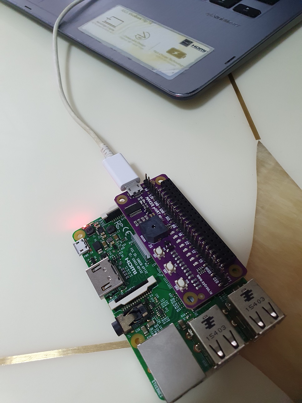

How i connected it to the Raspberry Pi

Postby sharmainee » Wed Jul 01, 2020 2:57 pm
Attached above are the pictures of the error message displayed and the connection of makerphat to the Raspberry Pi.

Postby ober » Sun Jul 05, 2020 6:16 am
I believe that is due to insufficient power from the USB port. Because you are powering up the Raspberry Pi 3B through the USB cable from your computer through the makerphat. Try to power the Raspberry Pi 3B with another power adapter.

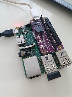

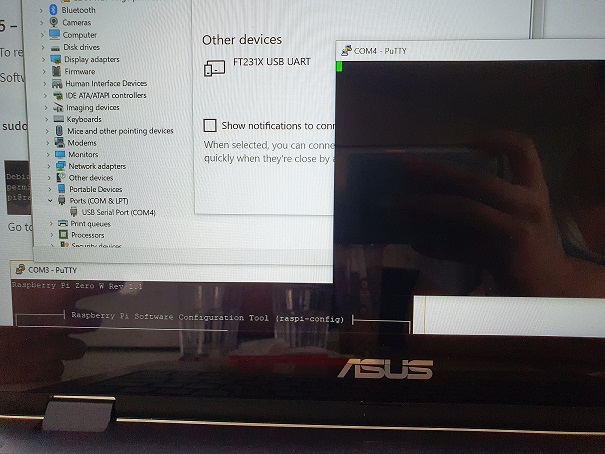

I have followed the your advice but am not sure if what I'm doing is correct? I connected the Raspberry Pi to a power source and the makerphat to the laptop, however, whenever i try to start up Putty, the green light on the Raspberry Pi immediately disappears. This is what I see on my laptop and how i connected it. Once again, I hope to receive your help and thank you for replying!
makerphat rasp pi.jpg (49.37 KiB) Viewed 14543 times

Postby ober » Sat Jul 11, 2020 2:45 pm
Well, that looks good to me. As long as the Raspberry Pi responds then it is working.
Since you want to use the UART on Raspberry pi, have you enabled the Serial Interface under the config?

Postby sharmainee » Tue Jul 14, 2020 12:53 pm
Thank you for your help! Is the enabling of serial interface done through the Putty Configuration? If so we specified the serial destination and set the speed as suggested but when we opened and when we pressed enter, we had the same display screen as in the pic above.
