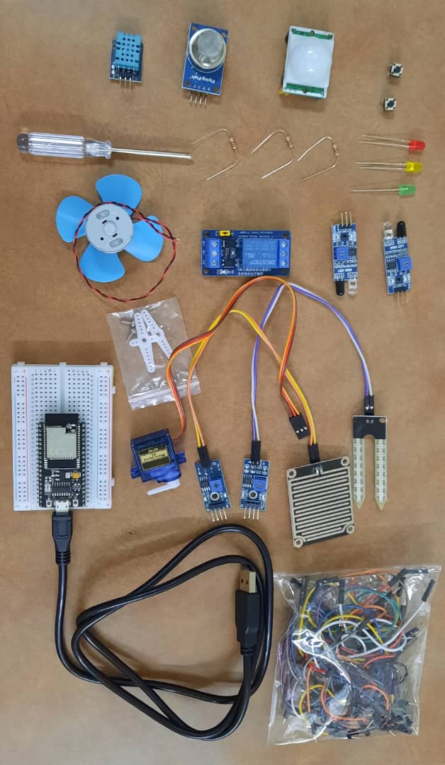

rodyeo WROTE:Many Thanks Hairil to have start up the forum page for NodeMCU-ESP32S IoT Kit - Simplifying IoT with V-ONE for Makers Q&A sharing channel ...
Here is my vlog of the product reviews ... https://www.facebook.com/rodyeo/posts/p ... TCMVSFow7l
Will document the user experience first time exploring the V-ONE IoT Kit for dummies
