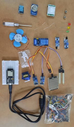

This is a quick view of all the parts of NodeMCU-ESP32S Iot Kit ...

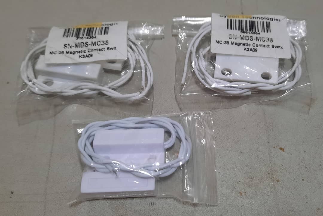

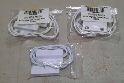

Dear Hairil,
Yes, it does resolves my problem, but I am viewing from being IoT automation via V-ONE platform instead as that was the purposes of this IoT Development kit.
But never mind if that does not include into your existing Cytron.io IoT Kit course product development plans as it takes many level of management approval for any product enhancement.
I will attempt to do the reed switch sensor build on my if possible and share with the community if anyone is interested to adopt later on their own as this features are bare essential for any IoT sensor needs and requirements for any Makers desires in Home Automation needs.
If V-ONE Free account does not allow an expansion of a simple Reed Switch Sensor add on function then I will need to look into alternative like ESPHome @ Home Assistant ... https://www.youtube.com/watch?v=IvI1RqYPO24
Thank you.
Rodney

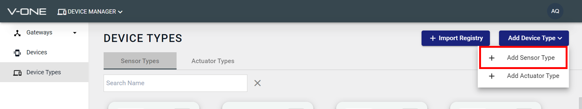

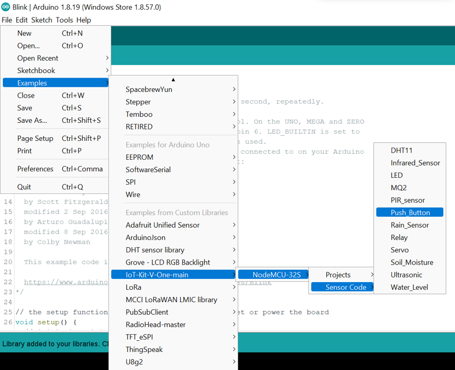

Hi Rodney,
Yes, you can use the reed switch sensor with the V-ONE platform. Actually, the concept of reed switch sensor is pretty similar to the push button. So you can just the same settings to setup the reed sensor and add a "new device type" in the V-ONE.
For the code, you can just modify a little bit of the code for Push Button that is also included in the library.
Add new device type
Push Button code
