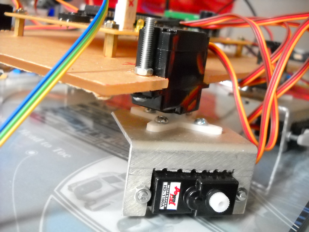

8 servos

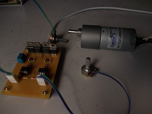

u can try to use dc geared motor as a servo if you deal with a massive torque...
