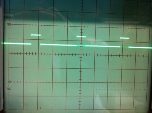

Can you please take a picture of your PWM signal on the oscilloscope and post it here?
I suspect your PWM signal is not correct.
FYI, the PWM signal for servo should have pulse width between 1-2ms and period must be around 20ms. In another words, the PWM duty cycle is only 5-10%. If you connect the PWM output the LED, the LED should be very dimmed or even not turned on at all.
In your case, if you can see the brightness of the LED changed, I suspect the PWM signal is not in the correct format to drive a servo.
*P/S: The servo can be driven with 3.3V signal perfectly. For R/C application, the servo is driven by a receiver which most of them only has output signal at 2.8 - 3.3V.

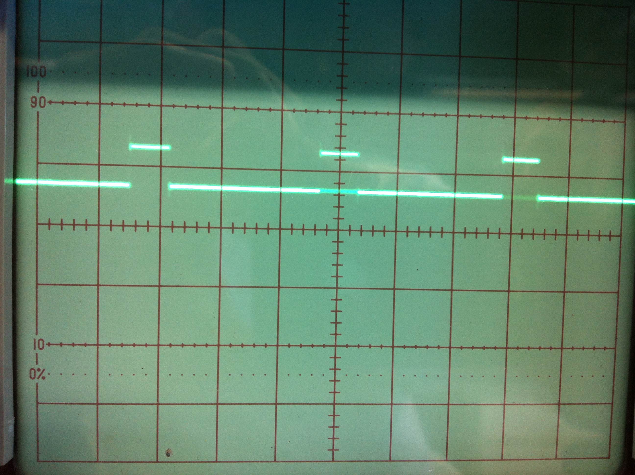

Postby hrzrfn » Wed Jun 05, 2013 4:28 pm
hi all..thx for your reply..
I've tried attaching the servo while checking for PWM at the osciloscope...it seems that the waveform is still there,just that the servo doesnt move
anyway here I attached the pic of PWM signal with setting at osciloscope 5volt/div at vertical and 1ms/div with 10x magnification at the horizontal part

Postby waiweng83 » Thu Jun 06, 2013 11:47 am
From the display of the oscilloscope, the period and pulse width of the PWM signal is incorrect.
Please make sure the period is 20ms and pulse width is within 1-2ms.

Re: PWM (3.3V) unable to drive servo
Postby hrzrfn » Tue Jun 11, 2013 1:41 am
Hi.. Thx for pointing out where my mistake is
Sorry for silly question, but what is the period of the pwm signal that i've posted? I've set 1ms/div for x-axis with 10x magnification at the osciloscope.. The 10x is confusing me wether i should divide the 1ms by 10

Postby waiweng83 » Tue Jun 11, 2013 11:03 am
hrzrfn WROTE:Hi.. Thx for pointing out where my mistake is
I'm sorry that I don't know as well cause I never use that type of oscilloscope before.
But I'm sure the signal is not correct from your picture because the ratio between the pulse width and the period is wrong.
