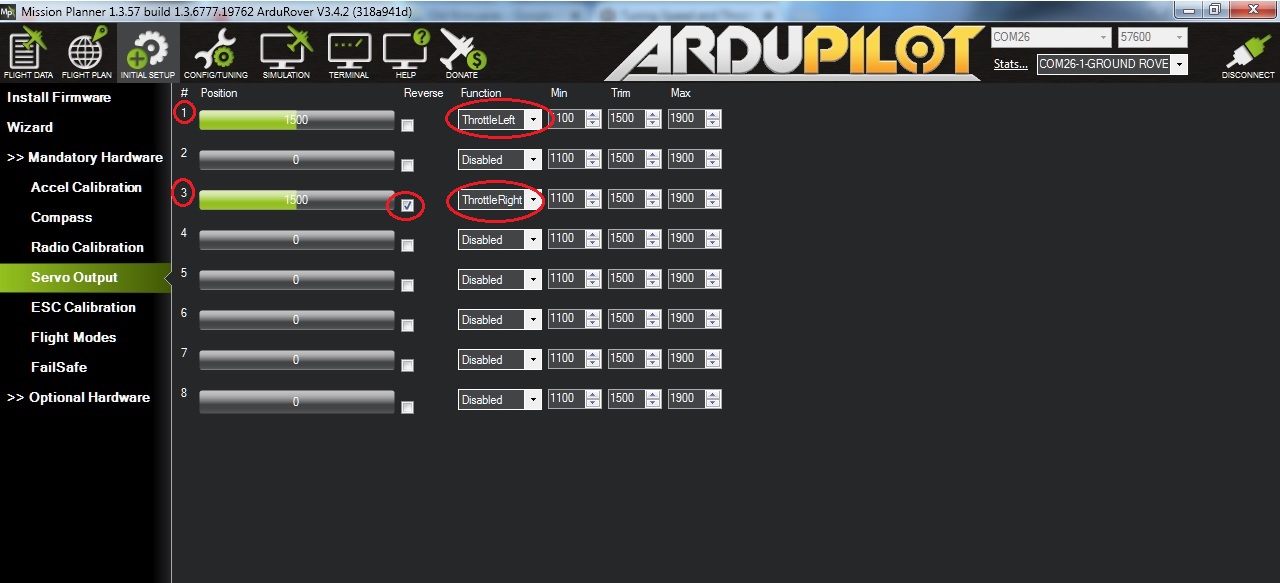

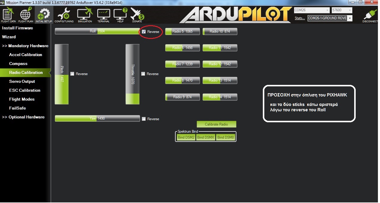

gianakop WROTE:Hi again,
After a lot of tests, a successful way to connect SmartDriveDuo30 and Pixhawk is to set SmartDriveDuo30 in RC Mode with microcontroller (Indepentent Both) and connect Pixhawk’s RC1 and RC3 outputs to RC1 and RC2 SmartDriveDuo30’s inputs using two 3Ways Connector Extension Wires
On Mission planner sofware you can also do the following:
1) From menu: INITIAL SETUP--> Mandatory Hardware --> Servo Output set: #1 Throttle Left, and #3 Throttle Right(tick also the reverse option on that)
2)From menu : INITIAL SETUP --> Radio Calibration Tick the Reverse option
hi gianakop
Why did you reverse the throttle right and roll channels on the mission planner. When I try this way, the control commands I use are not correct.
