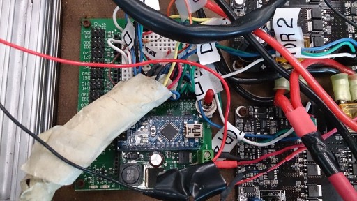

I have hooked up the arduino to an independent 12v SLA. Now I am able to produce 4.4V at max duty cycle PWM signal. However, I would like to achieve 5V. May I know how else I can modify to improve it?

Well, you might not get 5V even if the PWM is in full duty cycle.
You can try making the digital pin high instead of using PWM and compare the result. During 100% duty cycle, it is same as HIGH. To really check whether it is full duty cycle, you will need oscilloscope.

Compared digital pin HIGH and PWM at full duty cycle gives me the same voltage output. Doesn't generate enough torque as expected still.

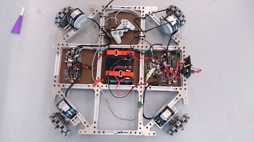

Just activate one motor to check whether the control and driver is working. If you activate all motor and it can merely move, it is most likely because your battery does not have enough power to support all motor.
