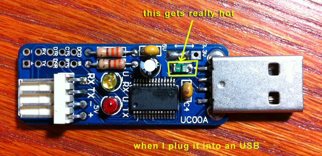

Unfortunately the UC00A that I got isn't recognized by the OS (Win7) and I noticed that one little component gets really hot. Maybe it was plugged in the USB for 5 min the longest before I noticed the component getting really hot. ( it gets hot in about 5 seconds, burns ) So .. I guess it's defective. See attached pics.

I don't quite understand what do I need to do with the UC00A
Please connect the UC00A to Arduino Mega.
Is the UC00A supposed to be connected to Arduino ? and while connected should it be attached to an USB on the computer ?
the UC00AA isn't recognized at all by WIN7 , I don't get the new device detected.
So to go through this once more: Arduino should send some Serial to ... lets say Serial1. and UC00A should read that .. and then read that in the computer ?
Or while UC00A is connected to the computer read output withe serial read on Arduino ?
I can't make sense of it. Then I don't really know how to use the Realterm ... step by step instructions will be the only way till I figure it out. To be sincere, I don't really want to learn this too. :) Not that I know to much of anything else.

About UC00A, you need to know that this product is actually a USB to UART converter. It creates a virtual COM port in your computer. You need to install driver for it to function. You can get the driver from UC00A product page. Installation guide is given in that page as well. I'm using UC00A on both my Win7 laptop and PC without any problem so far. Since you cannot get UC00A to work on your computer, so it actually haven't communicate with SD02B too. So whether SD02B's UART interface has problem is still unknown.
There're two problems here - to make sure the UC00A is recognized by your PC first, then get it to communicate with SD02B through the VB software which can be downloaded from SD02B product page.
