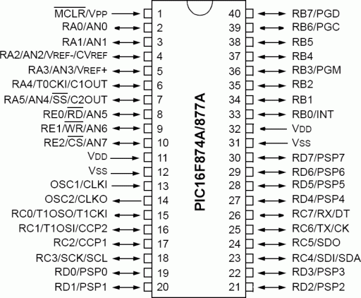

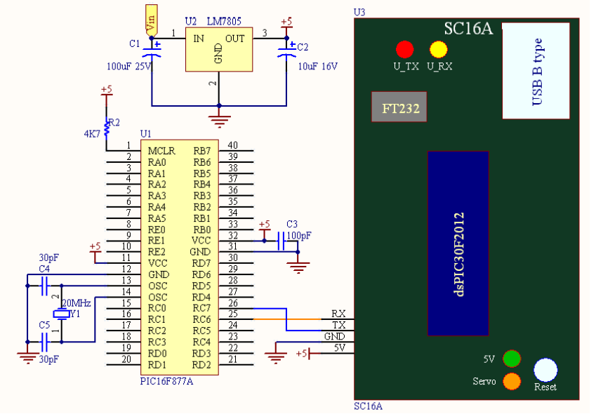

Postby zhenning » Mon Nov 19, 2012 12:14 am
RC6 -> TX is connected to SC16A RX and vice versa.

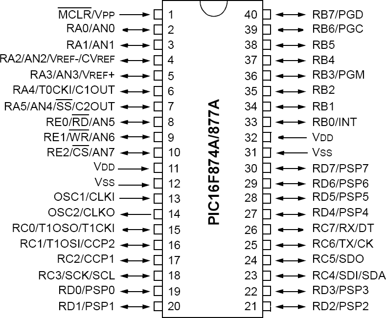

Postby gadgetng » Mon Nov 19, 2012 2:36 pm
should be
RX to TX
TX to RX
