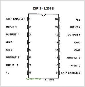

The on board Driver is L293B, you should be able to control up to 1A of current for motor. Extra 2 motor you need to use the free IO. The free IO means the part where you see the header pin at prototyping area, near to LCD.

is that the correct connection of L293B..
PIN OUT OF L293D

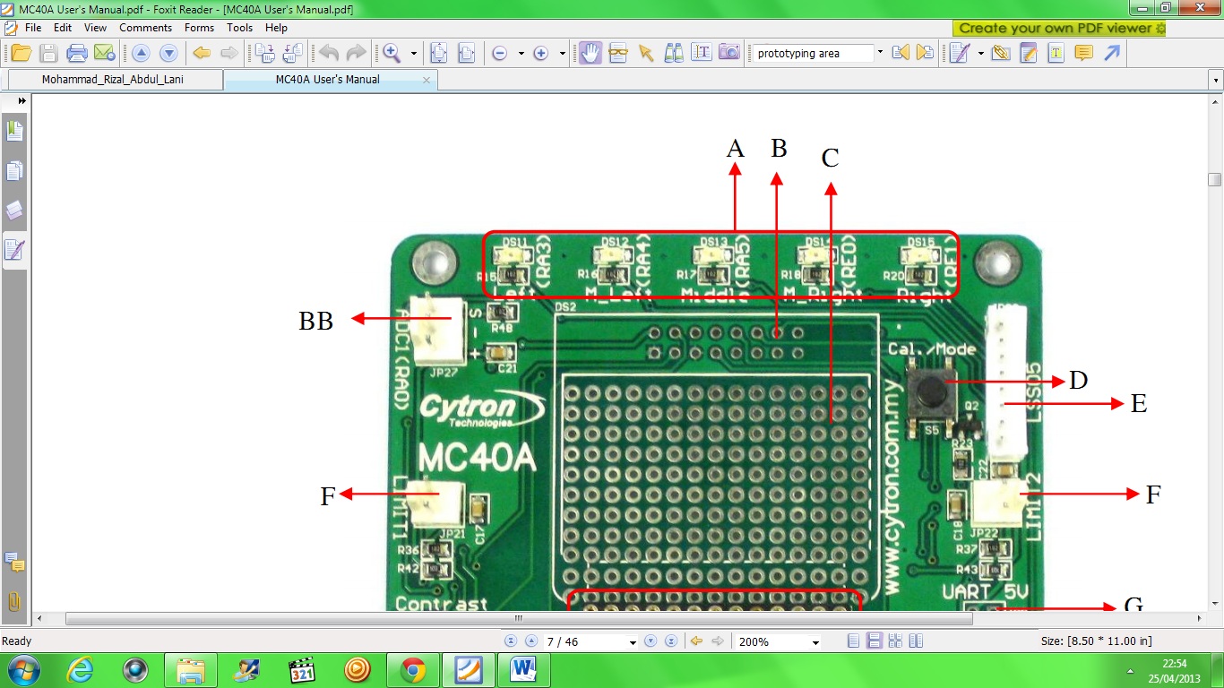

board layout of MC4OA
is that true that C is represent the free IO that ur talking about. ..
if true how many port/pin that are available(not used)..
if ur have any picture may its will help me...

Re: Mini Mobile Robot Controller(MC40A)
Postby robosang » Sat Apr 27, 2013 8:53 pm
If you look at the User's Manual clearly, it do state that the pins under the prototyping section are the free IO pins.
Also, check the schematic.
