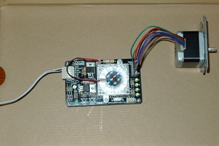

Thanks for your reply.
Attached is a photo of my setup.
I use the A/C 12 V / 2A power source from Cytron (AD-12-2)
The stepper motor is the one from Cytron too (17PM-J319-02ST).
The DC switch is positioned on Vmotor.
Wiring between the board and the motor is straight.

My setup

So I tested the wiring.
The brown cable was not correctly settled in the motor's provided connector. If this wiring comes from the manufacturer, it seems a bit odd. If from Cytron, well..., not so bad after all, this problem gave me the opportunity to dive seriously into stepper motors. (actually, the sheath was covering all the strands, thus no connection)
Thx Sich, all is well now, problem solved :)
