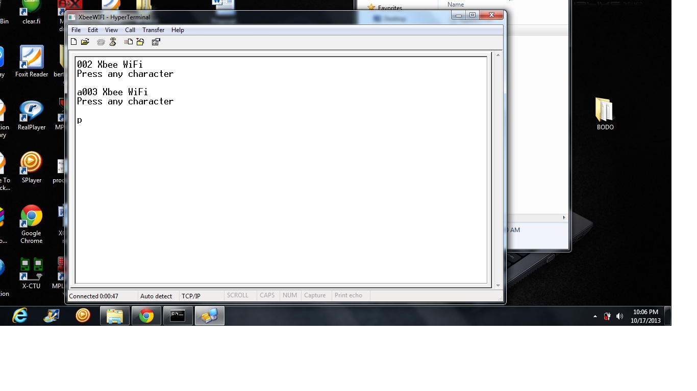

Re: Remote Mobile Robot with XBee-WiFi
Postby Idris » Wed Oct 16, 2013 5:18 pm
Hi mohamadhanifnayan,
After doing the Xbee-WiFi configuration, did you test the both way communication? I mean laptop send data to Xbee-WiFi, Xbee-WiFi send data to laptop.
Postby mohamadhanifnayan » Thu Oct 17, 2013 10:10 pm
is that what u mean
this is my result
after that i cannot press anymore.... sw2 or sw1
i receive xbee wifi S6B.. is should be no problem right !!!!..

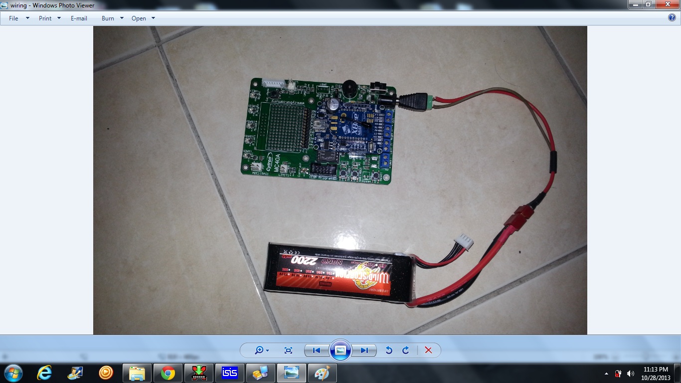

Postby ober » Thu Oct 24, 2013 5:56 pm
Mind sharing the photo of the hardware/wiring of the robot? Do show the connection from microcontroller to the SKXBee with the XBee-WiFi.
Postby mohamadhanifnayan » Mon Oct 28, 2013 11:14 pm
this what i mean...
mohamadhanifnayan
Posts: 7
Joined: Thu Oct 10, 2013 2:21 pm
Postby robosang » Mon Oct 28, 2013 11:24 pm
I don follow this thread, but I am interested to see the setting under the SKXBee. Can you share another photo without the SKXbee?
