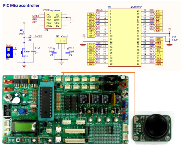

-can I know connection of the joystick you mention. I wanted to use two joystick you mention, can I know how the connection of wiring joystick and MC40SE.
-secondly, I wanted to know Single joystick can program without using SKPS. What if two single joystick connected to MC40SE? Whether can or not?

Shukri Ismail WROTE:can I know connection of the joystick you mention. I wanted to use two joystick you mention, can I know how the connection of wiring joystick and MC40SE.
You can read the User Manual, understand the function of each pins. It consists of 2 analog pins and 1 digital pin, then connect those pin to corresponding pin on the MC40SE.
Shukri Ismail WROTE:secondly, I wanted to know Single joystick can program without using SKPS. What if two single joystick connected to MC40SE? Whether can or not?
Not really clear with your question. You still can program two joystick connected to MC40SE "with or without" using SKPS.

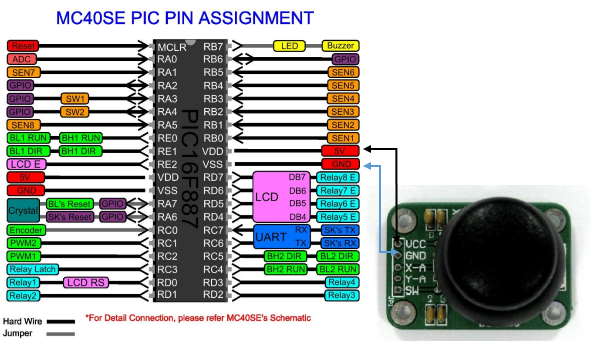

what i mean is. the joystick you mention above, i wanted to use two of it at MC40SE, but i dont know the connection of it and which port (MC40SE) should be use to connected with the joystick.
i also want to know how to wire multi led to MC40SE, which port should be use?

shukriismail93 WROTE:what i mean is. the joystick you mention above, i wanted to use two of it at MC40SE, but i dont know the connection of it and which port (MC40SE) should be use to connected with the joystick.
1st, you need to understand of each pin on the PIC microcontroller that you are working, especially analog and digital pin. Then refer to the MC40SE schematic to trace which PIC pin connect to which connector. Connect joystick (2 analog, 1 digital) and led (digital) to corresponding connector pin on the MC40SE.

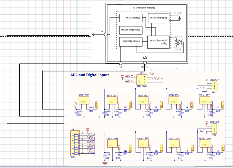

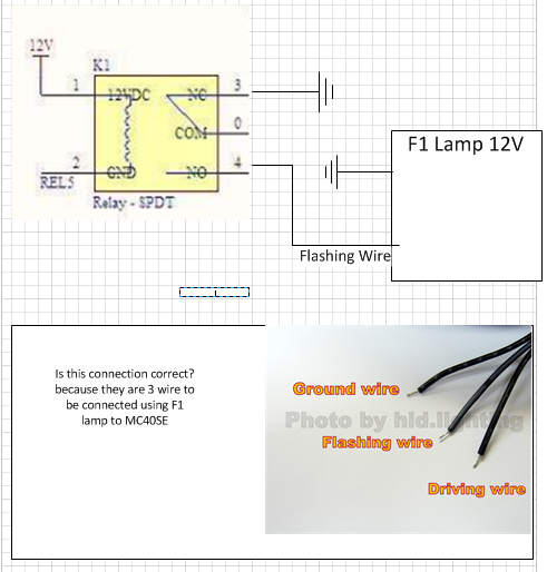

Postby shukriismail93 » Tue Feb 18, 2014 1:23 pm
SIR ASAP!!!

Postby Idris » Tue Feb 18, 2014 3:28 pm
Hi shukriismail93,
Please read PIC datasheet to get full information about each pin. RA0, RA1, RA2, RA3, RA5 are ADC pins and there still have more.
I'm not sure about the lamp (have 3 pins), you need to confirm how its work by reading the datasheet.
