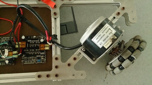

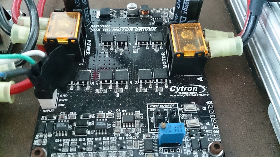

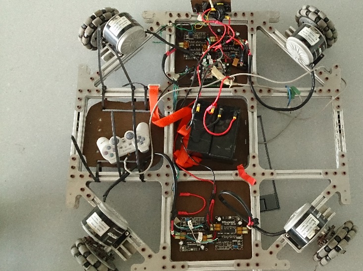

Postby Tunaz » Thu Feb 05, 2015 10:25 pm
I have attached the picture as requested.
May I check whether it is possible to use analog pins from the arduino to the PWM pin of the motor controller?
The analog pins are able to produce around 4.6V.
I have tested the arduino without any load and it seems to be able to supply 5V just fine.
Could it be an error in the coding?
Full set up- Two 12V SLA in parallel powering the project
MD30C
One out of the 4 controllers+motor+wheel setup
