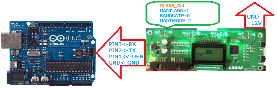

According to the user manual of SLA08 in order to get information from the line follow sensor via UART, we have to pull the UEN down and send a packet to LSA08’s UART, which it's for instance "0x01, 0x44, 0x02, 0x47" after that we expect to get the data from the TX line of SLA08.
So according to that I connect the SLA08 module to arduino UNO as shown in the circuit below, and also wrote the following code
#include <SoftwareSerial.h>
SoftwareSerial LSA(2, 3);//2 RX,3 TX
void setup() {
  LSA.begin(9600);
  pinMode(13, OUTPUT);//UEN PIN
 LSA.print(0x01); //SET packet
 LSA.print(0x44); //SET packet
 LSA.print(0x02); //SET packet
 LSA.print(0X47); //SET packet
  digitalWrite(13, LOW);//UEN PIN
Serial.println(LSA.read());
  delay(2000);
to send a set packet to the module and read the data out from SLA08. But, unfortunately I got nothing, Can tell me what is the wrong in the circuit or in the code?!?

Connect the RX of LSA08 to ARDUINO pin 3
Connect the TX of LSA08 to ARDUINO pin 2
Connect the UEN of LSA08 to ARDUINO pin 13
Connect the GND of LSA08 to ARDUINO GND
Then,
Uploaded ARDUINO with softserial with 9600 baudrate sketch as shown above.
At the serial terminal set the baudrate to 9600
Then,
Got nothing.
Nonresponse.

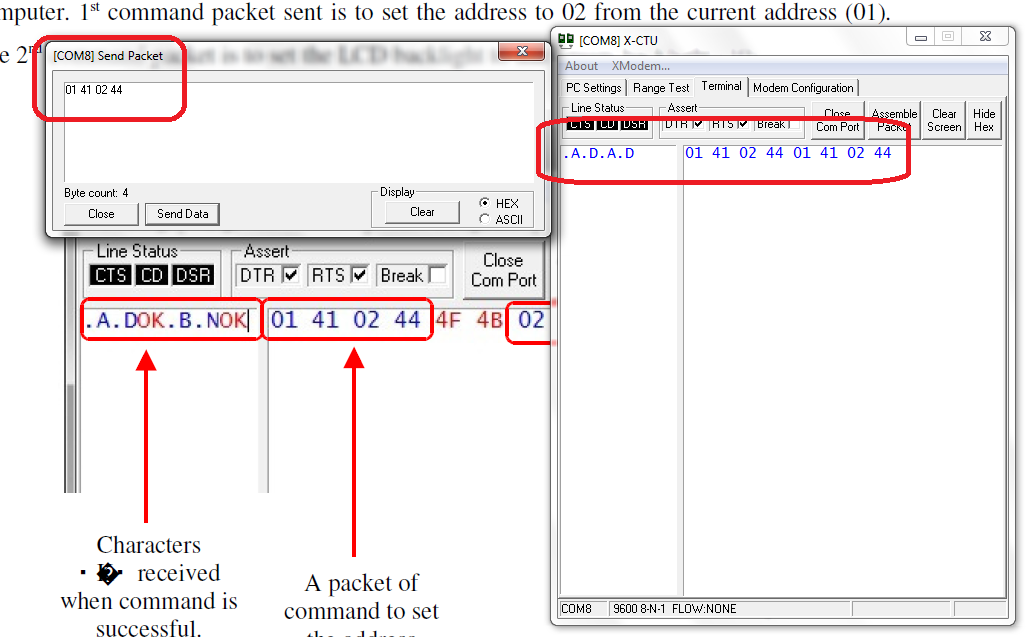

Send a data packet "01 41 02 44" as shown in photo bellow.
Then Send a data packet "01 43 00 44"
Then,
Got nothing.
Nonresponse.

X-CTU
