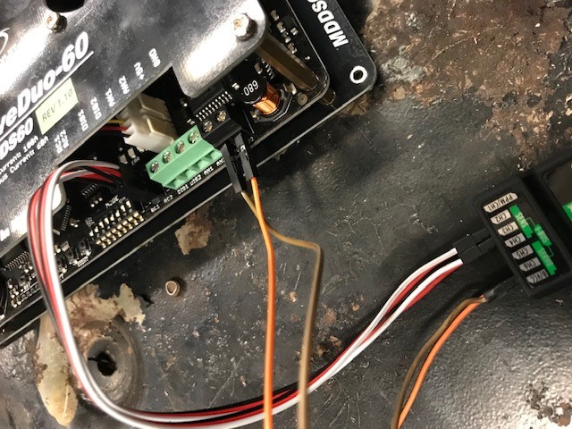

Hi, can you capture and share a few clear photos of the MDDS60 and the wiring? Video is more than welcome too.

Postby Bahn » Thu Apr 25, 2019 8:14 pm
I've attached four images...

Postby ober » Fri Apr 26, 2019 5:43 am
Thanks for the photos, helped us understand the setup a lot.
Most of the setup are correct, except a few, though it should not be the cause to the problem you are facing, yet highlighting it might be helpful for future setup:
1. The power cable is too thin for 500W (250W x 2 motor) load
2. The RC receiver does not need additional 5V from the screw terminals, it comes from the 3-pin header that you already connect for the signalling.
As for the problem, can you please contact our support team at support@cytron.io, they will help to arrange for warranty.
