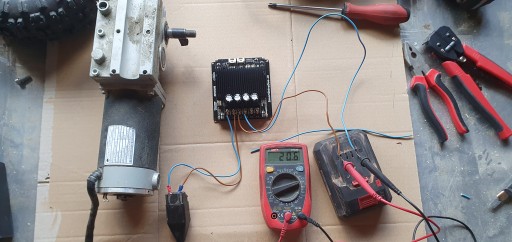

Hello fellas.
I am a bit frustrated with my current setup, so I hope to somebody can help me out and show me that I doing something wrong here.
I am building RC lawn mower and my setup is:
Wheel chair motors 12-24V 250W
RC controler FS-I6 with FS-IA6 receiver
Test battery LIFEPO4 20V 4AH.
I have connected battery to VB + and VB-. Motors run normally when connected directly to the battery.
Motors are connected each on MRA and MRB, and MLA and MLB correctly.
When I power it on, only light that is on is pwr light.
DIP switches are all set in RC input mode, with all pins set to zero, as default.
Now, I would suspect that I have incorrectly connected FS RC controler, but let me first check with you. MRA, MRB, MLA and MLB buttons are used for testing, and nothing happens with motors when I press them.
This is my concern that is something wrong with my driver.
Am I doing something wrong, or this could be faulty driver.
Thank you,
Marko

A few photos or a video of how the actual setup and the error indicator LEDs response would be helpful for troubleshooting.
Re: MDDS30 wont run motors
Postby odvratni » Wed May 10, 2023 8:10 pm
Hello Ober,
Thank you for your reply.
Here is the photos of the setup and a videos.
https://youtube.com/shorts/j1ltuebw56Y?feature=share
Thank you
Marko

Postby waiweng83 » Thu May 11, 2023 11:34 am
It looks like the motor driver is faulty. Please contact support@cytron.io for further assistance.
Thanks.

Postby odvratni » Thu May 11, 2023 3:18 pm
Thank you for quick reply.
Replacing this one with working one.
