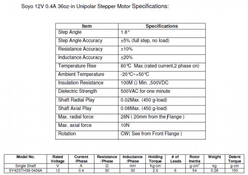

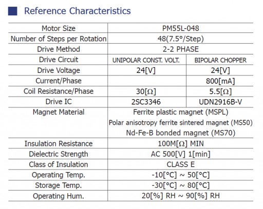

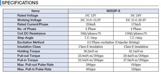

How would I figure out the frequency of stepper motors ? Specs sheet ? Trial and error ? Push it till I max it ?
Specs one motors are attached as well !

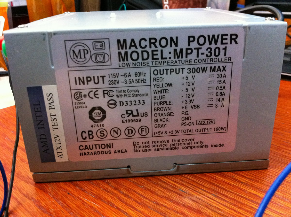

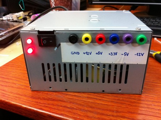

My PSU has the following specs and there is no current limiting feature. See pics attached.
Thanks again! Sorry for the flood of pics. I am a photographer .. :)

bspin WROTE:How would I figure out the frequency of stepper motors ? Specs sheet ? Trial and error ? Push it till I max it ?
My way of doing it is through trial and error since most of the stepper I have don't come with the datasheet. By increasing the speed until it fails to run smoothly, the value before it is the max frequency. Please note that a free run and a loaded motor will give different values too.
