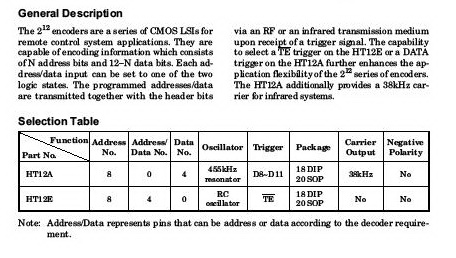

I'm having problem on how to interface ADC0804 to encoder HT12E. :cry:

The output of ADC0804 is 8 bits (correct me if I'm wrong) and the HT12E has 4 bit data and 8 bit address. I dont know how to interface them together without losing accuracy.

Honestly, to send data through RF without using a MCU is not that easy. Your weight data after ADC is 8-10 bits in parallel form. To send them by RF you have to serialize them using a parallel to serial converter like 74HC165. There are also ACIA, UART, USART chips (6850, 6551, 8251 etc) but they need MCU or MPU to control them in order to work properly. Using the parallel to serial chip to send data through HT12E is not easy as you have synchronization problems to solve.

Thx for your concern n knwledge...actually i using flexiforce sensor. now i doing experiment about my signal conditioning and record the data. the conversion to digital i cant imagine how to connect to HT12E cause ADC-8-bit and HT12E-4-bit. if parallel to serial are used, HT12E in parallel right.(correct me if i wrong).there is no ADC for 4-bit?..Huh, its quiet hard.maybe i should consider to used MCU.
