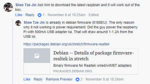

I had just unbox the Raspberry Pi 2 and installed Raspbian OS. unfortunately, from the Raspbian OS top right cover, it showed with "No wireless interface found". But i believe my wireless adapter does not compatible with the Raspbian driver. Can you kindly please guide me on the wireless adapter setup as well as the configuration? I had tried out to search for some assistants online but still unable to make it. The details of the wireless adapter is as below:

Hi saxon20044,
I have ask around and most of the response said that it should work with the latest Raspbian. However I could not verify it because I don't have the hardware.
