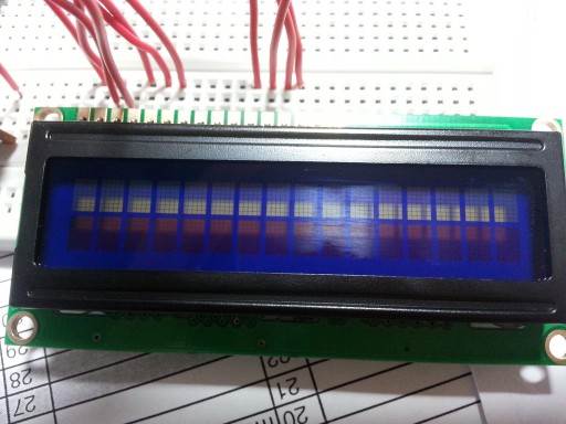

i bought a LCD (2x16)- Blue Backlight from cytron, and i using Arduino Uno Rev3-Main Board. i follow all the instruction from this web page ;http://arduino.cc/en/Tutorial/LiquidCrystalDisplay . the code and wiring same as the page , but why the expected result is different ?
somewhere wrong ? even a character cant display it out .

Did you solder pin header to LCD or just put it into the hole?

Just put in the hole.Zzz.... because i used straight pin header(male).

if u dont solder the header pin to LCD pad, it is not properly connected. the signal might lose and cause the LCD not properly initialized.
before you proceed, you must solder the header pin to the LCD to give good connection between LCD and the header.
