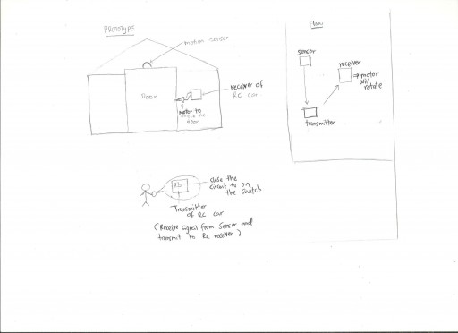

yeah, ABSF u right. i mean that the motion sensor would transmit signal to the Transmitter. the input of the transmitter using joystick.. i sketch the picture below to more clearly..in the pic, when someone come nearer to the door, motion sensor detect human body and send the signal to the transmitter of RC car and on automatically so that we don't need to push the toggle. if i not using the sensor, i need to manually use hand to on the transmitter. actually,the idea to on the transmitter is same like automatic lighting project.but, is it suitable if i use motion sensor instead of other sensor in this project or u have another opinion? :|

Re: about motion sensor
Postby ABSF » Sat Mar 03, 2012 11:15 am
It all depends on the sensor you used. If the motion sensor has its own electronics, it would be easier to do. Let's say if an object is detected by the motion sensor, it's output goes High. You can use the o/p to switch on a relay or an opto-coupler. The relay contact can be directly connected to the Tx inputs and trigger sending of signal. Upon receiving the signal by the Rx, it would switch on the Door Lock coil to open the door. You can place the sensor and Tx in the same spot.

So you're doing a MCU-less project. So, forget about the RF modules. Study more on the RC control and if possible try to draw a bit of its circuit on how the joystick is connected. And also the part how the receiver controls the motor in detail. Instead of using a motion sensor, use a push button switch and a 10K resistor. Connect in such a way that when the button is on, it is high(5V) and when the button is not pressed, it is low (0V). 8-)
Try to interface the button to the Tx and work until the Rx can respond to the switch. Say a high would on the motor and off would switch off the motor. Then find a motion sensor with built in electronics which gives a "H" when someone is near and "L" when someone is away. Connect the Motion sensor to the Tx and you have a motion sensor controlled motor....Hope you get what I meant. ;)
Replace the motor with your motor-controlled lock mechanism and your project is complete. No programming involved at all.
