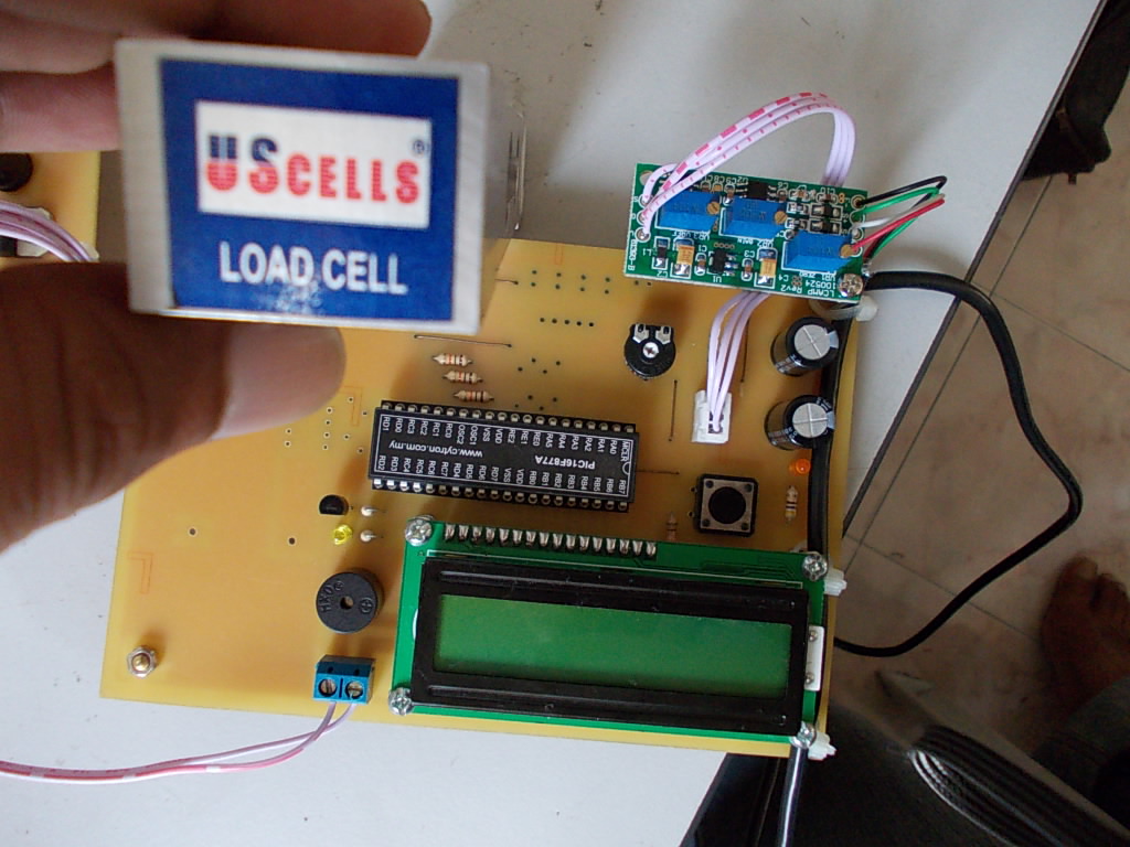

hi...i did last time...the advanture is there....sure u need xtra circuit..!
royalstorm7@yahoo.com
0 - 50 kg load cell circuitary

If i'm not mistaken, you would need a voltage divider to make it work. If the load cell have 3 wires, then i believe you don't need such circuit. Try google voltage divider theory and you'll know what i mean.

holy_rainman WROTE:If i'm not mistaken, you would need a voltage divider to make it work. If the load cell have 3 wires, then i believe you don't need such circuit. Try google voltage divider theory and you'll know what i mean.
The voltage divider not enough to read the difference. The response is very small until ADC can't see the different. I'm confident you will fail to use this method because I have tried before.
The solution is, use special amplifier like royalstorm7 said.

it just a simple instrumentation amplifier, very less info but just plug and play...ez to used...!
