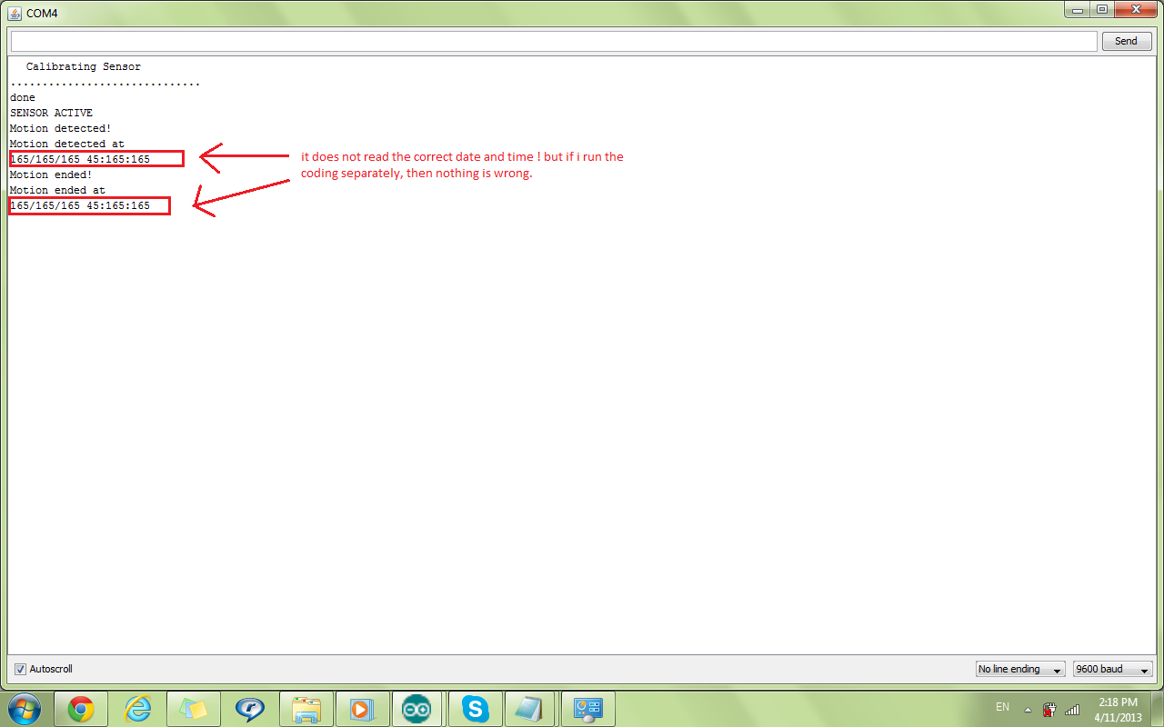

Hello, i need help for my project. I am trying to combine coding for pir sensor and rtc (real time clock). The problem is the program does not read the rtc time correctly. i need help! this is an urgent project. help!!

This is the combine code. I know is not that neat and tidy. But there still nothing wrong during the compiling.

Now the problem is as shown in the picture below. it does not detect the correct date and time.
I really need ur help. You may also correct me if there's anything wrong with the coding. Its a process of learning for me. But still i need to finish my project asap! waaaa!!! :'(( I really appreciate ur help!

Postby fatinathirah » Thu Apr 11, 2013 10:52 pm
ok found the prob already. i forgot to put wire.begin() before setDateTime() . problem solved. cased closed. XD
