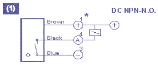

Yes it is compatible with Arduino You can refer to the M18 Capacitive Proximity Sensor Wiring Diagram
Operating voltage: DC10-30V
Output signal: NPN, digital

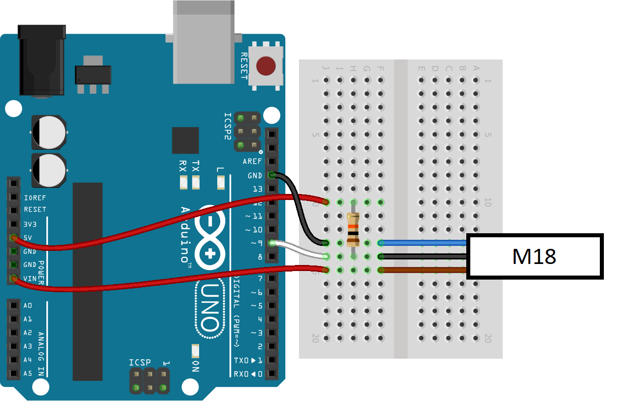

Since Arduino IO pins is 5V, you can make connection something like this.
Then read digital signal at pin 9.
