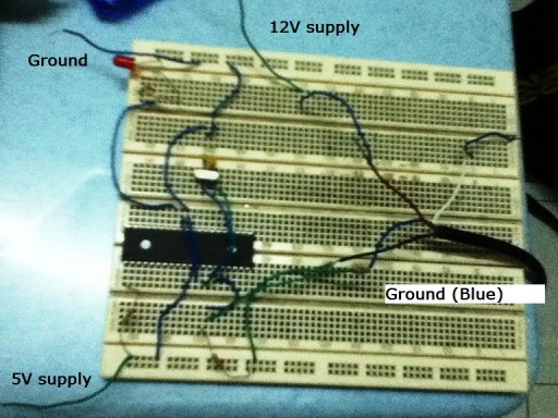

Photo of real hardware should be helpful
Re: M30 Capacitive Proximity Sensor
Postby kenshih » Tue Oct 18, 2011 1:13 am
this is the photo of the circuit i constructed, currently having nothing on it as it is meant for testing the sensor as well as obtaining the sensing range of the sensor. it is similar to the pic i post earlier.
Postby robosang » Fri Oct 21, 2011 7:38 am
Em.... :roll:
I think I will suggest to connect the pull up for sensor and power the sensor only, test the sensor alone.
