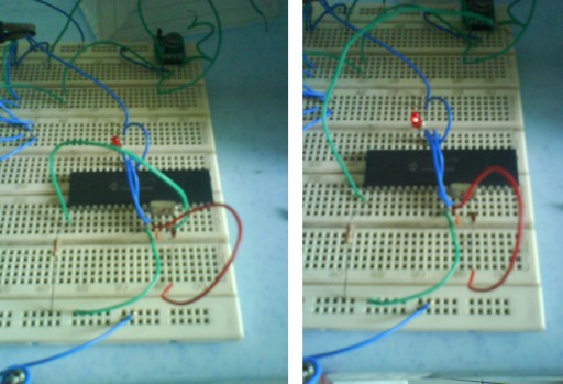

It will be good if you can show the setup of this test through photo
Re: M30 Capacitive Proximity Sensor
Postby kenshih » Tue Oct 25, 2011 2:35 pm
ober WROTE:
kenshih WROTE:3. and lastly the circuit alone with "manual switch"(i used jumper wire connected to 5v along with a 10k ohm resistor to represents '1' and connect it to the input pin and pulling out the jumper wire for '0') (results: LED changes state[on/off] as i pull/plug the jumper wire)
the picture on the right shows the circuit when the input jumper wire (green wire) is "hanging"(0 bit), from the coding,
if (ss0==0) itm0=1;
else itm0=0;
note: where ss0 is RC0 and itm0 is RB0
and the picture on the left shows the circuit with the input jumper wire attached to the input pin,
from the state of the LED, it shows that the coding and circuit im using is working fine.
