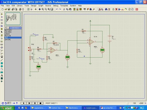

Postby ABSF » Wed Mar 02, 2011 9:44 am
picpicpikapika WROTE:
From what I know, when the light intensity is stronger the voltage output of the receiver will be lower (I am using voltage divider circuit for the receiver). It means when a white colour or reflective surface is approaching my transmitter and receiver, my voltage divider output should be decreasing. On the contrary, when a black colour or nonreflective surface is approaching my transmitter and receiver, my voltage divider output should be increasing.
I have tried with the white colour surface and the outcome is ok...it is able to decrease to minimum 3.7V from 4.5V when I put the white colour surface above a certain distance on top of my sensor, and my comparator output was able to act accordingly.
But when I tried to experiment with black colour surface, the voltage change was insignificant, maybe from 4.5V to 4.6V...with the insensitivity of my comparator we can expect nothing will happen :lol:. So I would like to ask how to increase the voltage difference when we are using black colour surface(but I think it is quite impossible since my supply voltage to the receiver is only around 4.8V). Or is there any other methods??
OK, There is a way to work around this problem. On white surface the range is 3.7 to 4.5 and on dull surface it's 4.5 to 4.6V I'll give you an example how I'd do it just to give you some ideas.
First, use 1/4 of LM324 to make a difference amp and strip off 3V from the sensor input. V1 is the sensor voltage and V2 is the offset voltage (3V). The output will be 0 to 2V coming out of the 1st op-amp. Then connect this output to a second op-amp with a gain of 2.5. The output from the 2nd op-amp would be 0 - 5V. This output is then fed into your comparator so it has a bigger range of change. Even a dull surface now would have a change of 250mV. The schematic is attached here for ref.
But of course, in real world, it is not possible to get 0V output from LM324 due to the high offset input voltage (check the LM324 datasheet). So the minimum I can get is .5V on 1st op-amp and after amplified by 2.5 times, it is 1.25V on 2nd op-amp. So the output of 2nd op-amp will vary from 1.25V to ~4.5 volts.
op-amp with offset and gain=2.5
