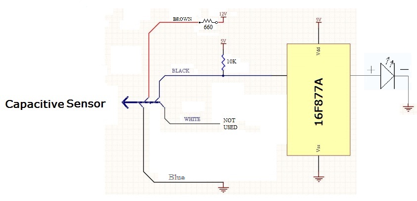

Postby kenshih » Thu Oct 06, 2011 6:46 pm
this is the circuit i constructed for the capacitive sensor, took the original circuit from the B106 Rotary Encoder User's Manual and edited it according to the circuit i have.
circuit for the capacitive sensor
the coding i used to test this sensor is:

Postby hyng » Thu Oct 06, 2011 7:22 pm
Please try to detach 660 ohm from your circuit, connect 12V source directly to the sensor. Hope this will help.

The code seem to be correct. Maybe the resistor highlighted by hyng should help.
